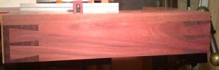

In the woodworking world, and there are some fairly practical people there because the edges are then used, often to failure THAT DAY and then resharpened to continue working THAT DAY it is fairly easy and quick to observe what works and what doesn't work as well. I mean I have changed the angle on some super blue chisel steel ($500 chisel) when cutting purple heart and the edge went from what appeared to the naked eye as "chipping" (actually folding/dinging) to the edge cutting perfectly and for a long time in huge joints. Just by changing the edge grind angle about two degrees (measured on a guided sharpener) .
These joints (that is a one foot ruler for judging scale).
So it has been "determined" by trial and error by the hand tool woodworking community, pretty much, that the kind of motion on the stone that you describe especially on coarse stones promotes early edge failure due to introducing stress risers that can cause the edge to fold over.
This is all very microscopic and perhaps not that important in a pocket knife but there you go.

PS :Every surface was cut with hand edge tools / no sand paper or power tools have touched this bench.
