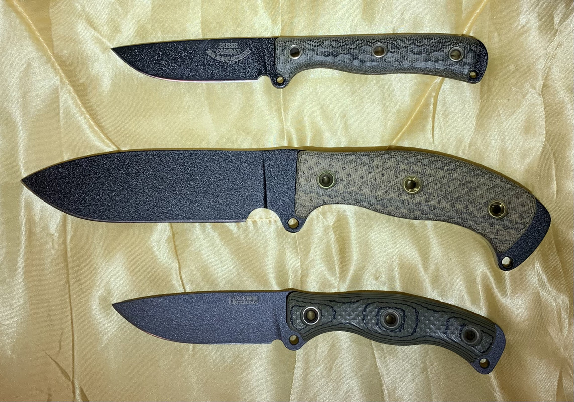

I'm looking at a Busse Hack Wardog (large model, 5" blade, 9.875" overall, double cut bead blasted INFI) which coincidentally was mentioned a few pages back – seems to be a limited run at the 2011 Blade Show? There's not a single review I can find on these online... (no YouTube videos either) so need a little help.
Are these really Busse knives? The blades are only marked with "HACK" and I don't see it listed on the BusseCollector site either. Scrapyard (I know that's Busse kin, but not Busse proper) seems to make a near identical "WAR Dog" (no "Hack") version, same length and all (I think there's a slightly shorter version as well). What is the difference on the Busse version (if it's really a Busse)? I read the grind is different on the Busse... I am worried about using such a thick knife for camp/bushcraft type chores... **EDIT, I've now seen MULTIPLE people referencing there being "Hack" versions of Scrapyard knives too... so I'm confused.
Can somebody explain to me what the "#1 of 12" on these means? Normally that means there's only ONE knife (in a certain color/finish/handle-color combo)... But it seems like every single one is #1 out of 12 - and I'm talking IDENTICAL knives – same exact finish, handle color, grind, etc. Seen at least 4 of them (totally separate people) ALL have the same "#1 of 12" of the SAME EXACT knife! That kinda goes against the entire principle of a limited run, right? (and I've never seen the #2-12 either!).
How can I make sure this is INFI if the blade doesn't say it? You're all POSITIVE there isn't non-INFI versions out there (I'm a sucker for INFI having destroyed many different knife steels, but never INFI to date)? The weird numbering already has me worried a bit... And stupid question, but these are full tang knives, right? Like full height too (i.e. nearly the same width as the handles, i.e. not like a crappy rat tang a ka-bar has)?
Sorry for so many questions, I've only owned four or five 'regular' Busse's, complete with Busse stamps and micarta handles... this res-c handled type which looks near identical to a Scrapyard knife is a new type of Busse for me. Thanks.
