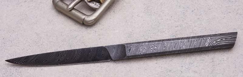

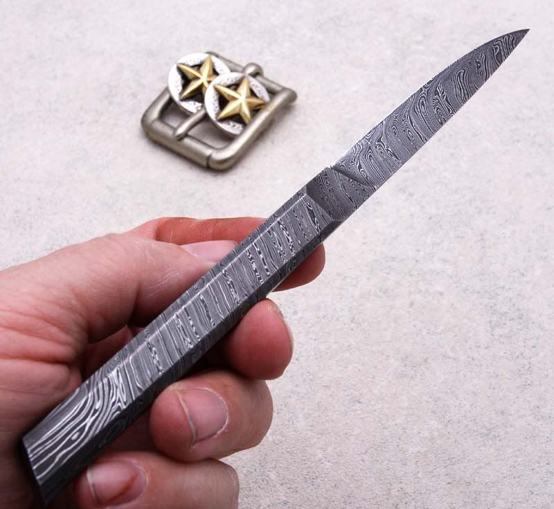

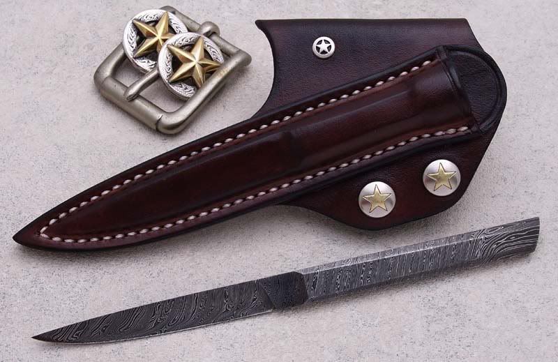

Here is the knife and you can see how it would be challenging, as he
wanted to carry it at an angle on his belt, behind him so he can draw it with
his right hand.
Tim Zowada SHARP beauty of a knife;
as you can see, no guard, no handle scales, no contours you could use to help
with retention and he didn't want a flap...

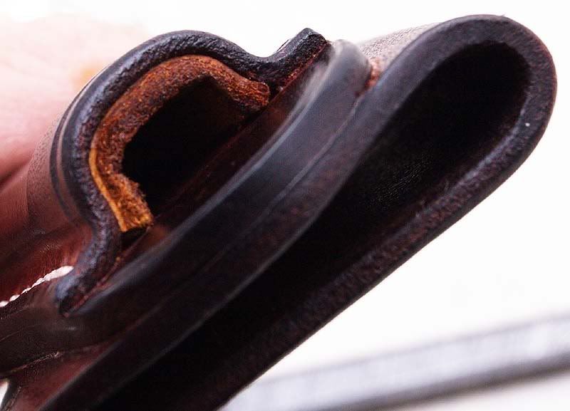

So I thought of an idea that I wanted to share, in case you guys/gals may end up in a similar situation.
I used a small piece of elk skin, the kind used for moccasins. It's thick and spongy in texture.
So I wrapped that onto the knife when I wrapped the knife with plastic wrap.
Also, in order to keep the blade UP while I use the bone folder to shape the top section
of the sheath, I cut out a piece of leather the same shape as the blade and
set that beneath the blade, so when I pressed down, the blade didn't also go down.

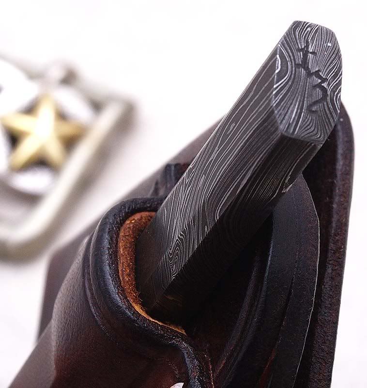

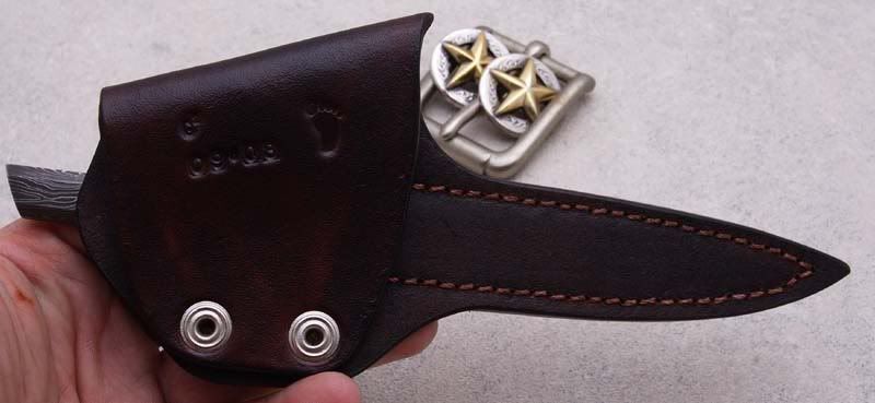

here is the opening of the sheath, you can see the piece of elk skin that is
glued up inside the top section of the sheath;
When you insert the knife, the leather will have a wedging effect as the knife
compresses it. On these I recommend to keep the knife out when not in use but
if it ever became too pressed, you can easily replace that small bit.
I left a small rounded end near the opening to help aid getting the knife back into the sheath
and it also runs the full length of the knife, so there are TWO layers of leather beneath the knife, just in case!

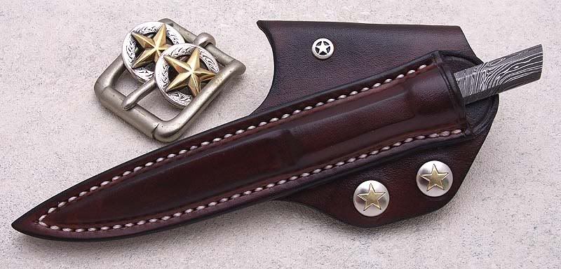

He had looked at my wife's uncle's sheath I did for the Tim Wright knife and wanted
something similar but not as steep an angle. and able to removed the sheath
off your belt without taking your belt off, so along the bottom are two snaps
The back side, I left the front lower side just a little bit longer than the back
so you can grip that and pull the snaps apart.
So, there ya go, man it's a nice snug fit, I just got in some snaps and that small
star there, he goes to a lot of western old timey things, so this will fit in some what.
Thanks for looking, hope it sparks some ideas for you guys,
G2

Thanks guys, it is a pain to make, for several reasons;
1. as pointed out, nothing to grip on the knife
2. even as small as it is and narrow a blade, that sucker is SHARP!!!
3. you have to set your holes and finish both edges BEFORE you glue it
down to the belt loop piece, as you can't trim it once it's in place
A tip about the stitching, to make it come out looking even at the tip
I start my stitching forks from the tip and go up to the opening, that way
you can 'fudge' where you end near the top, BUT no matter what you have
to go around that tip, so why not get that set and let the other ends fall
where they may!
G2

Matt, Steve pulled this knife out late Saturday night and talked me into
making him something. He goes to a lot of western gun thingys where they
dress up in that long ago garb of the cowboys, I ordered some Line 24 snaps
and saw they had a 10 piece pack with a Star on them and got those just
for this occasion. That smaller decorative star is a hammered in piece, but
didn't hammer in as nice as I like, it'll stay put but...
and being the type 'A' person that I am, a little bit of that detective Monk
as my daughter tells me, I took small pliers and turned the stars so they would
line up with the top of the sheath when worn on the belt ;)
G2

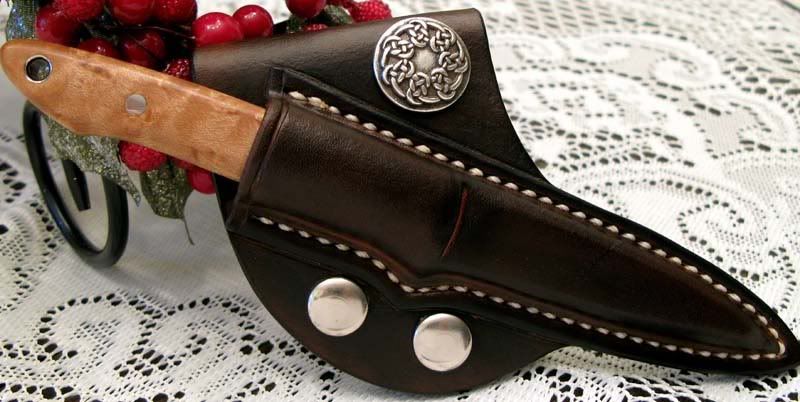

It was a special request from my wife's uncle and made it as a cross draw to his spec's
I also added the celtic knot concho that I picked up from tandy while in FL
The guard area of this knife provides a nice snap in feel and gives a secure position
for it in the sheath.
You can read/see more of Tim Wright's stuff in this thread started by SharpByCoop Here
it has some very cool folders and also this knife out of the sheath, nice stuff!
compared to the Right side carry and less tilt;
