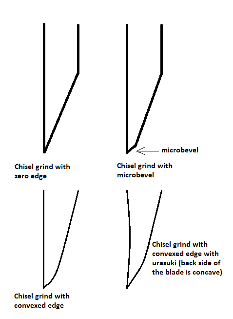

I see the terminology used in many ways, in my opinion you can bring any micro bevel to a zero edge but a zero grind has no small or micro bevel... it only has one grind going directly to the edge.
As both an engineer and an amateur knifemaker, I agree with that definition.
That said, making it happen and really work is not as easy as it seems.
The final geometry is what makes the knife a real user or not.

Thanks for posting the awesome diagram by the way!

A big plus for the chisel grind is the fact that the drag inducing points from bevel angle changes are cut in half. Every time a grind changes angles it creates a point; micro bevel to edge bevel, edge bevel to primary bevel, and the same for both sides of a V ground knife! Some will argue that a convex grind (Moran grind) eliminates this, but it also creates a larger tool angle making low angle cutting difficult without skipping. It also puts lots of steel behing the edge, making it actually more difficult to sharpen the edge. Another effect of the convex edge grind is that it produces low height micro-bevels creating massive wedging/tearing effect.
Edge condition on the micro level involves grit finish and things like how keen an edge is to produce lasting cutting ability. Smooth edges "feel" dull because they don't catch and grab when infact they often will slice you without ever feeling it! Think of a polished edge of a razor blade, it has the most steel at the very edge and lasts much longer than say a 400 grit edge. A coarse edge will feel sharper because it will grab nd tear like a micro saw, but not last as long. It is a good choice for people needing quick cuts with minimal strokes, but may not necesarily care about retention. That's where steel alloy comes in, but I don't feel like opening that can-o-worms right now.
