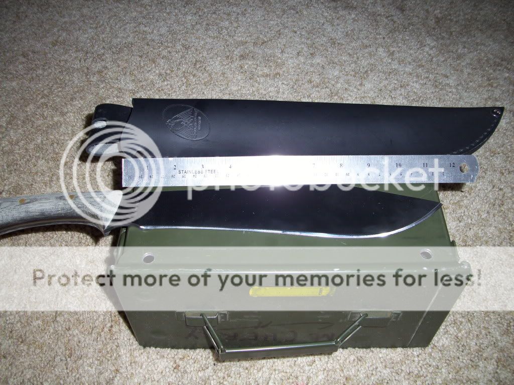

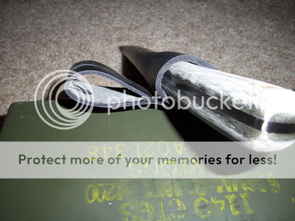

Just received my Condor Boomslang in the mail today. Man, i just LOVE getting new knives, but i will try to be objective in my review.

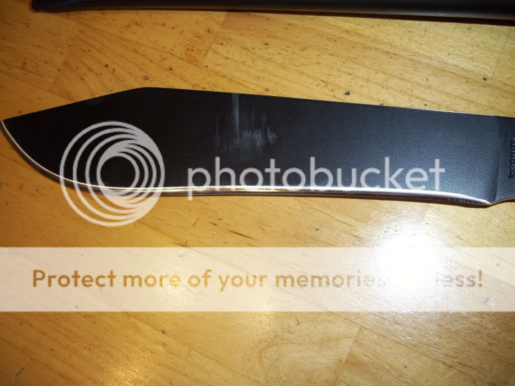

It was sharp & would shave paper, but one side of the edge was off. Fit & finish was top notch. No gaps between micarta handle & tang. Sheath is AWESOME !!! Thick heavy duty leather. I have never owned any knife/sheath combo that did not have a snap or velcro retension strap. This one does not. Did not think i would like it but i do. You can turn it upside down & shake it & it does not come out, i am impressed.
Then i sharpened it. It is still not quite where i want it, but it is close. It is 3/16" thick.

The micarta handle was perfectly smooth with the tang/rivets. GREAT JOB !!!
You can see that the leather is as thick as the knife. AWESOME !!!

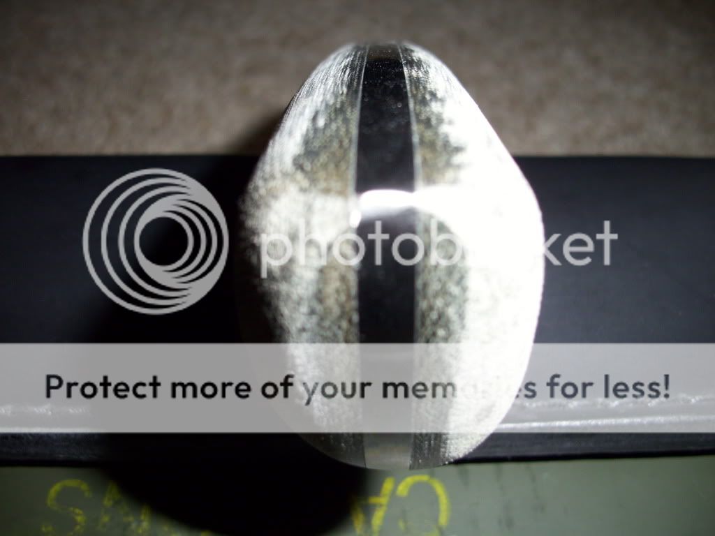

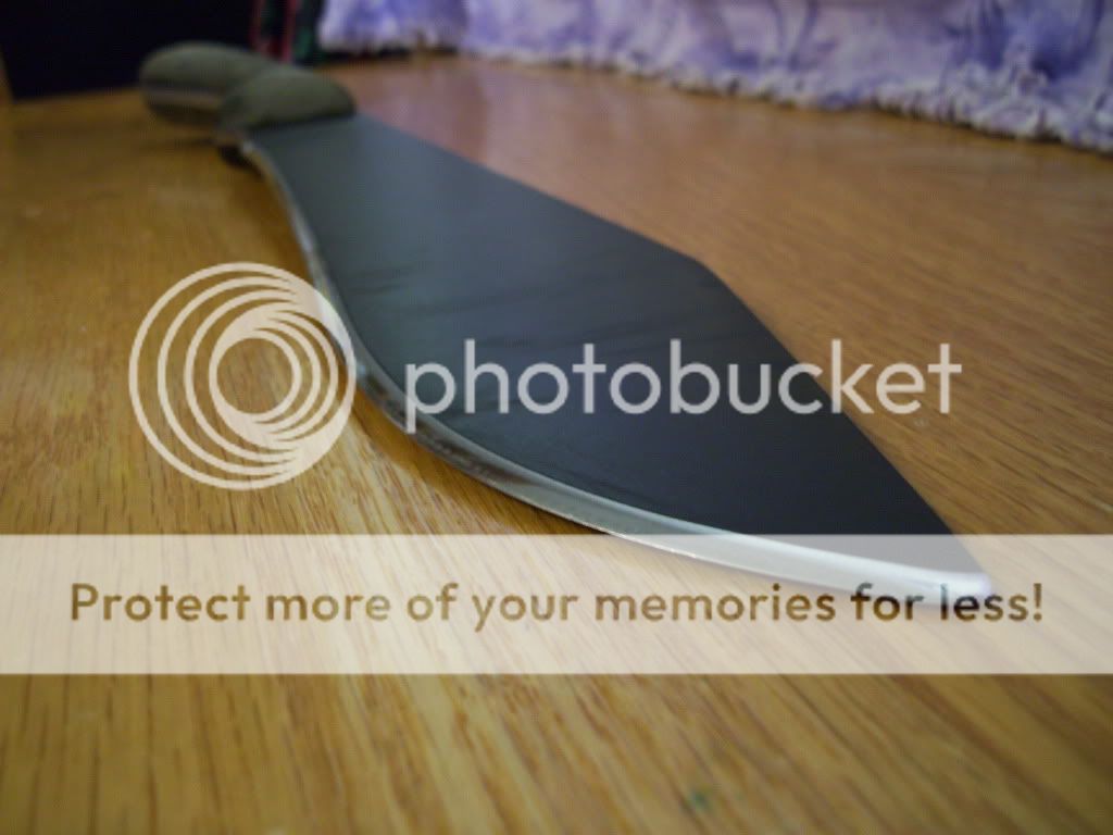

OK, here is the regrind update. I reground it, made it thinner & i think convexed (which it was to begin with), but i have to work on the tip some more, I took the sharp point off somehow. It chops about 100% better now & is just about on par with my BK9. I think the BK9 still chops better because it is lighter & that means faster, but the difference is VERY small now. Here is a pic of the grind.
Good work with the edge thinning! The biggest thing I've found with convex edges is that it's easy to have a good edge angle, but have shoulders that are too thick. Knocking the shoulders off always makes a piece seam a lot sharper because of less energy be lost due to material displacement!

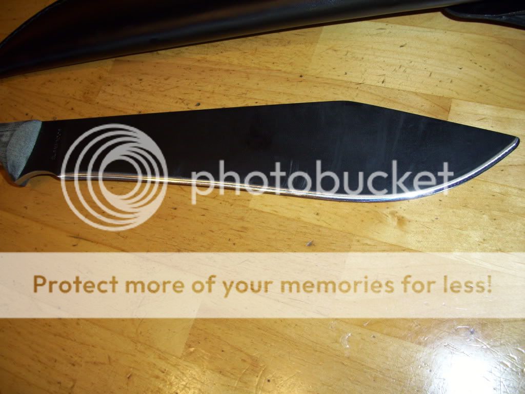

Another update. I took a whole day & sharpened the Boomslang to 25 degrees on each side (50 degree inclusive). I feel it now chops as good as the BK9. I had to take a lot of metal off. It is an awesome chopper now that i have an excellent edge on it.
Awesome! The biggest problem I've always had with production knives as a whole is they aren't sharpened as thin as they could be. Rather than optimizing performance for pros like us they play it safe and leave the edge at a more common man's angle to soak up their abuse. :p
Nope! The only reason why a thicker edge is "better" for chopping is it's less prone towards damage. If the edge on a tool is capable of being brought thinner without taking damage in use, it's to your advantage to do so. The thinner geometry bites deeper because less energy is lost to matter displacement as the blade moves through material.
