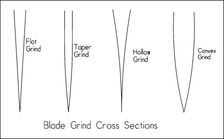

OP, check out this pic to see the difference between some knife grinds.
Your mora is a taper grind, it looks curved in the pic but it's just a flat v, also called a scandi grind.
The bump you feel is just the transition between the flat grind and where it begins to convex, most likely.
This is actually one of my favourite edges, convex edges are tough, sharpen easily, (once you learn the tricks) and slice really well.

In my limited knowledge base I'd call it a modified convex. The blade starts out as a flat grind but has mini convex right at the edge bevel. It blade grind starts a steep taper to a slightly larger bolster of metal right before the edge bevel. Hope that makes sense.
Gah. So much confusion here. Allow me to correct it. :)
The Condor Kephart has a full flat grind with a convex edge. The factory edge angle has been a little obtuse on some runs but it will slice like the dickens once you thin it out.
Condor IS doing hollow grinds now, but the only model featuring them is the Dundee Bowie, which has a hollow saber grind. Very well executed and crisp, I might add.

It's not really possible to convert a full flat grind to a scandi... >_>;;
