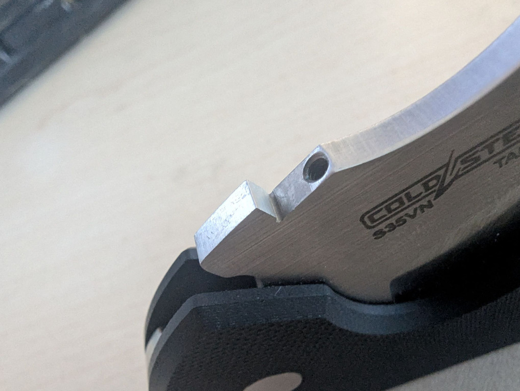

When the Big River offered a limited time deal on a fully serrated Tiger Claw for under $90, I just had to give it a shot. I know it is straighter and sports a lot of handle, but I figured that the Thumb Plate would aid in deploying the knife and act pretty much as well as the add on Snaggletooth I purchase for my more tactical knives. UGhhhhhh, I'm so irritated with this this design😒
IMHO, that Tiger Claw does not lend itself to the thumb plate opener. Due to the shape of the blade, drawing it in a forward grip requires a rolling that will snap it open at the expense of potentially cutting any shirt in its path or your back pock of your pants. OK, no big deal. I was planning on drawing this in a reverse grip, as one my gripes with a lot of other Karambit style folders is that they aren't designed to be opened in a reverse grip. My Microtech Hawk Auto is a glaring example of this. Anyway, I move the pocket clip over to the left side so that it draws in reverse with my right, and I can probably deploy this thing with a practiced drag maybe 70% of the time. 10% of the time it opens 90% but doesn't lock up. 20% it doesn't overcome the back spring and snaps shut where careless fingers might fall. 😳 I nipped myself twice trying to find a reliable way to draw this knife, and I was going slow and trying to be careful.
I would have either cut out under the disk more to give it a better grab or just licensed Emerson to use the wave feature. The thumb disk is a joke on this short and inward curving blade. I decided that I would take the disk off and see if there was anything I could do to modify the knife to give a better grab on my pocket. What I found does not inspire confidence.

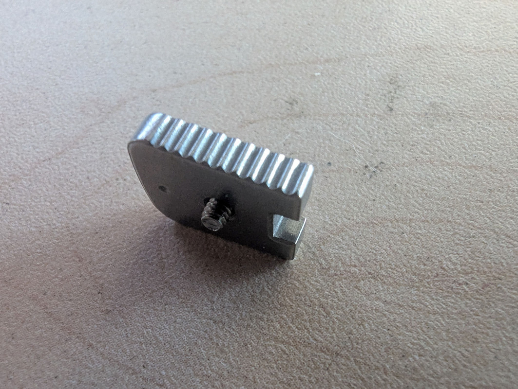

I had never taken one of these off, be it on a CS or the Emerson ZT 630. I had thought that maybe there was a stair step down where the disk would rest on a little notch to lock it in more. Instead, I see its just this one short little T6 with a tiny bit of thread lock and nothing secondary to take some of the lateral stress off the knife nor mitigate the stress of pulling that plate upward over and over again. You can also see the slop in the over-cut of the blade.
Honestly, I have figured out how to wrist flick this knife open in a reverse grip, so I think that's what I'll do. That scrawny thumb plate isn't going back on there. Actually, the step that plate rests against isn't much worse than the plate itself to wave the knife open. I think I may take a dremel and just wallow that area out where they cut too far back and see how it grabs.

As far as structural integrity goes, they probably thread in and work just fine or else we’d have heard stories about Emerson and Cold Steel thumb disks and plates breaking off or other issues. The only one that comes to mind is a Kershaw Emerson blade snapping at that area.

You can do a mod , to make a cutout notch in front of the plate , like it comes on the Black Talon 2 .
Helps with catching the wave ! And preventing cloth getting stuck there , getting hung up .

I filed the plate into a ramp and it helps to "wave" open the blade. Just mark the plate where it starts to touch the blade so you don't go too far ,then file a hollow rounded shape into the underside of the plate. It opens up the area where it will catch the fabric of your pocket and helps it grab. I did this to my Talwar and it helped immensely.

I did the exact same thing with this TC, and it does help a lot. The curvature of the blade means you really gotta still yank it if you want it to overcome the detent. If you do it half-assed, then it can slam shut and catch your finger:P But yes, grinding it back to a ramp really really helps to grab the seam of your pocket better. I have a large Talwar on my short list if the XL Recon doesn't drop sooner than later.
