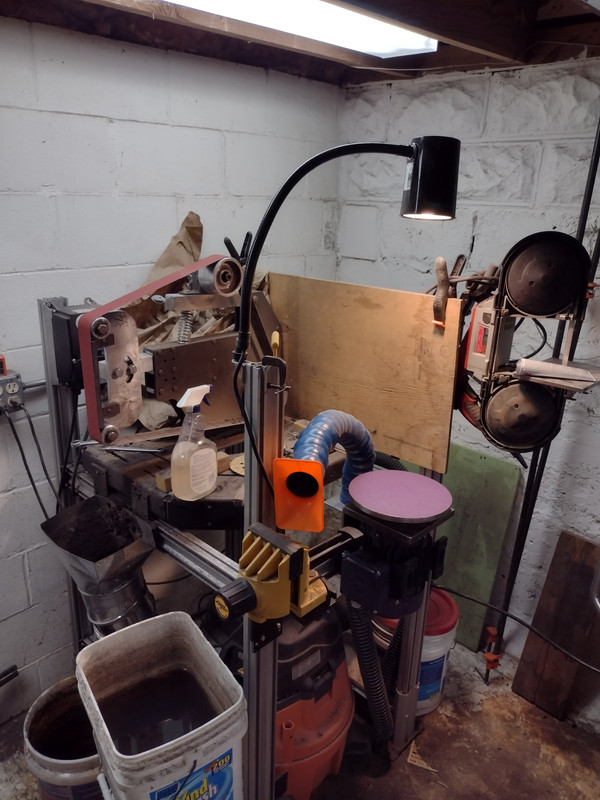

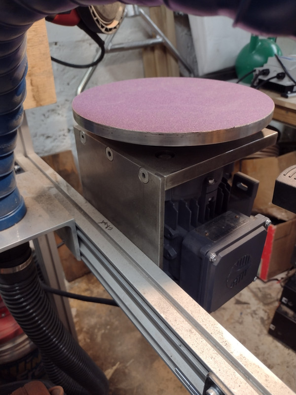

Ok........ So I made one, and it's wired, and it runs.

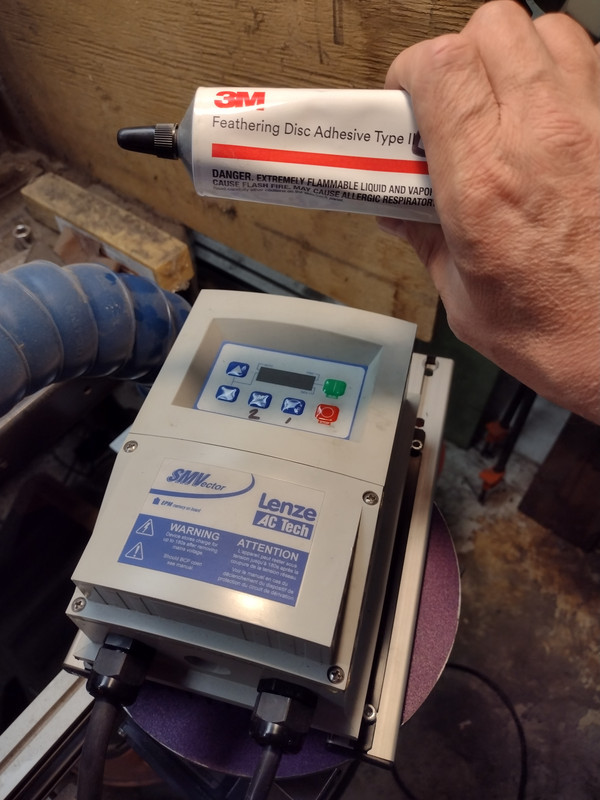

I got the feathering adhesive from the local auto body supply.

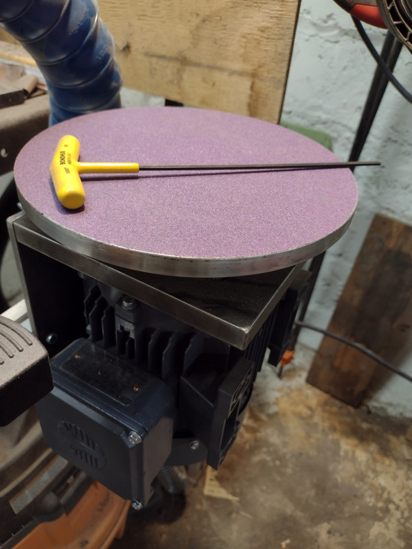

My test knife.... I accidentally put a gouge near my edge because of getting fast and cocky and accidentally tilted against the outer diameter..... Grrrrrrrr!
I still don't know speeds either, so far slower than I first figured?

Here is my little dirty part of the Universe....
I don't have my drive mounted yet.
Looks bad.... someday I'll take nicer pictures when it's cleaned up
Very cool…thanks ! I have that techtop style motor on my 2x72 and am happy with it as well.
I’ll look into that drive. I’m far from savvy on motor control but I appreciate a nema 4 rating as my shop stuff, like everyone, takes a dust beating.

I could mount mine on its side, but I think I'll like it like this better.
I still don't know what speeds are needed?
At a certain range of frequencies it vibrates. Faster and slower it doesnt.
I'll have to play with it. Maybe it needs more support? I could weld a gusset on it...
