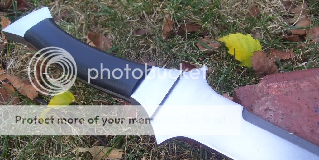

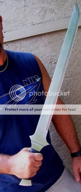

Hi friends. Finished this custom piece up for a customer this week. Probably add it to the website here in a couple weeks. Hope you like it.
Shop Details:
1095 Spring Steel. We Heat Harden, heating the steel to approximately 1500 degrees, until it becomes non magnetic then quenching it in oil. Heat Tempered to 500 degrees for 2 hours, and letting it air cool. Rockwell Hardness of approximately 59.
The Dragon Slayer
Measurements
Total Length = 29 7/8 ”
Blade Length = 22 ¾ “
Blade Width = 1 7/8 “
Blade Thickness = 3/16 “
Handle Length = 7 ”
Handle Width = ¾ ”
Handle: Black Linen Micarta.
Weight: 3 lbs
I believe that qualifies as a sword. I WANT ONE!!!!!!!
Do you have a sheath to go with it, or is that up to the customer?
Man, I wish there would be still bad dragons out there, than I could justify to have this one too :-) Cause it looks like I want one.
Great blade,
Thanks guys for comments. Yes, I do provide a simple black leather sheaths for $39. I have it on my website now, if you want to see it.
