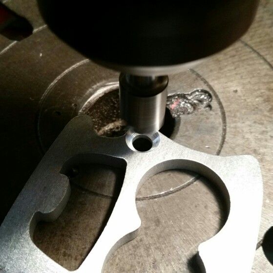

Anyway, these arrive as very rough blanks water jet cut from a sheet of .250" 6061 aluminum. I then chamfer each hole with my old and trusty Milwaukee drill press and a 60° bit.

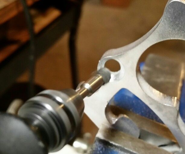

I clean up the chamfered holes with the Dremel and a wire bit. (shown in a vice only because I don't have three hands... I free hand this obviously.)

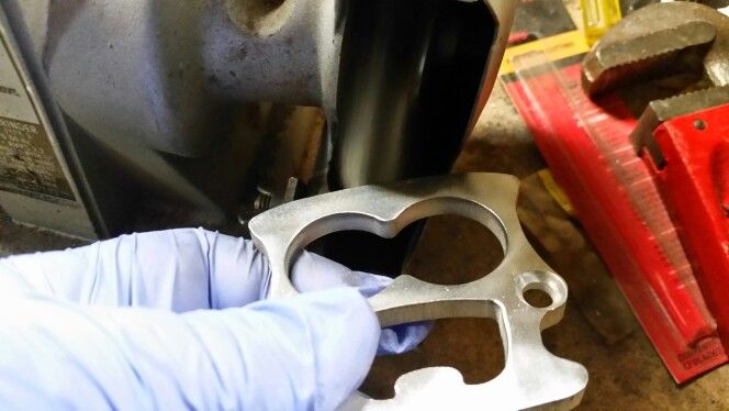

I will knock the corners down a little here and there by hand after the wheel. They then get dunked for a brief bit in a moderate acid bath before going in the tumbler. After a couple of hours in the ceramic media they are washed off in the sink and are done. Packaged up with a stainless split ring in a small zipper baggie and sent out the door, ready to open your favorite frosty beverage...

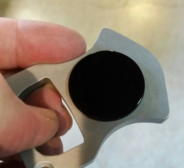

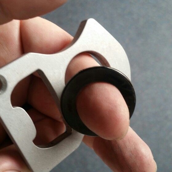

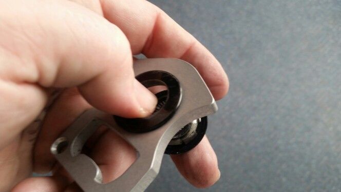

Ok, so I had an idea to work on a Deep Cover 'Minion.' I thought I'd share some mock ups with you guys and get an opinion. Unfortunately I neglected to take a top picture of the compass showing through the grommet before sending this off, but you'll get the idea.
Here is the back side grommet in place. For the top just imagine a 20mm fluid filled compass showing through..
The idea is to have the two grommets interlock slightly. Push out the compass portion like so...
And then take out the top surround grommet like so...
The actual pieces will be bespoke for the minion and probably a matte delrin of some sort. Possibly different colors, etc. I can envision company logos on the back, small watches instead of a compass, etc. It would make the unit extremely deep cover, and I think would avoid much scrutiny anywhere. Please excuse the rough mock-ups. This was one of those 'ah ha!' moments and I didn't want it to escape me. If I pursue this it would have to garner a decent amount of interest, and would be much cleaner and we'll presented as a final product. I could even see it as an add-on to the units that are already in customer hands...
Thanks for any input.
Cheers y'all!
-Eric
