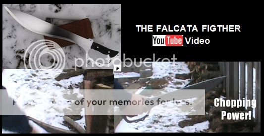

Hi all. Just completed this for a customer. Will be adding to the website soon and will be making a video on it.
Just Released the Video on it:
http://www.youtube.com/watch?v=GEZ1xeYrg00
The Falcata Fighter:
Shop Details:
1095 High Carbon Spring Steel. Steel is Heat Hardened & quenched in oil. Heat Tempered @ 500 degrees for 2 hours, and letting it air cool.
Measurements:
Total Length = 22 ¾ “
Blade Length = 17 ½ “
Blade Width = 2 ¾ “ widest point ”
Blade Thickness = 3/16 “
Handle Length = 5 ¼ “
Handle Width = 1 ¼ “ widest point
Handle: Black Linen Micarta
Weight = 2.3 lbs
Pictures below. Thanks.
