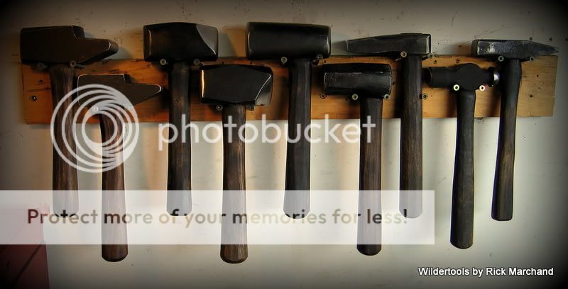

Hey Folks... yes... another hammer thread from me.... I just love em!!!
I'm really happy with the group of hammers currently have. My handles have evolved to a short(8-9") elongated octagonal cross-section. It is very similar to the Hofi-style. I rub a bit of beeswax on them to add grip so my hand doesn't have to work as hard to maintain control.
From Left to Right...
The first two are my French Hammers. 3.3lb and 2.2lb. I have been using these the longest. They are my all purpose hammers. If I could only have two, these are the ones.
The second two are my drawing hammers. 3.5lbs each. These guys draw out length FAST. They are modified 4lb mauls. Square faces with generous rads on the edges and RH/LH diagonal peens.
The third pair are my Japanese-type rounding hammers. The big one was made from a 6lb sledge and weighs in at 4.25lb. The smaller was made by Kenon Rain and slightly modified by me (sorry, Kenan, your work is great, bro) to reestablish the weight at 2.25Lbs. These two spead out steel like crazy but don't have the directional control that the square faced ones do.
The last three consist of a homemade Beveling hammer, a Ball-peen and a Rough Faced Masonary hammer to add texture where needed.
They all serve a purpose and get used regularily. There is one hammer not pictured. It is a regular 3lb maul and does all my dirty work like driving punches and chisels.
Please post your own hammers and tell us what you use them for.

Sure hope you got some long screws in the studs, that thing comes off the wall I can see some tender toes for a few days LOL

Great question, Count...
You knew I had to start with this pic... lol... thanks!

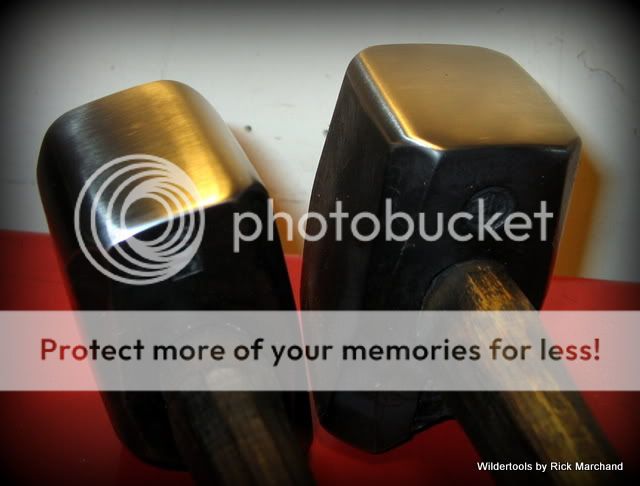

The French Hammers - I square the faces, the gently "roll" them side to side and top to bottom on a slack belt. Small radius on the edges to eliminate gouges from bad hammer throws.
The Drawing Hammers - Squared faces, rolled side to side(only) even more than the French hammers. The edge radius is larger so even while hitting with the flat face, I can angle/tilt it to get a fuller effect. LH/RH Diagonal peens for heavy, ergonomic fullering/drawing.
The Rounding Hammers - Round faces, heavily domed to spread metal in all directions.
Beveling Hammer - Ground to a "peen" that is flatter in shape. Used to gently draw down edge bevels on knives that are fully forged.
Texturing Hammer - A masonary hammer that has been roughed up to impart texture for touching up the "forge finish" look.
The Ballpeen Hammer is pretty self explanitory...
