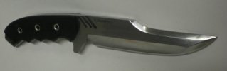

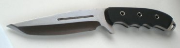

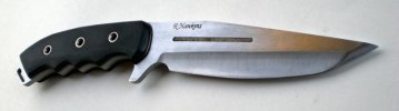

"The Finger" Need opinions on whether to keep or lose the finger grooves?
Just a practice blade (Proportions and steel are all wrong) but it's the handle design I'm not sure of.
This will proabably wind up as a shop or truck knife :barf:

If it works for you then I say keep them, but it may or may not be comfortable for anyone else imho.
Any time you cut more than one finger groove it becomes a situation of whose hand will fit and once that's decided this person can only hold the knife in one way. For a tactical or a hunter it certainly won't work. The workmanship from what i can see, on the other hand , looks well done. You did ask didn't you? And just my opinions of course. Frank
I really like it. But hey I put Micarta on Damascus. The first question is how does it fit in your hand? I don't agree with the fact that grooved knives only fit one hand size. Pick up a Randall Dive Knife with finger groove it will fit perfect. My wife is 4'10'' and I am 5'11'' a Randall will fit both our hands just like it was made for it. If it feels natural you got a winning design. You better send it to me for me to check out better. :)
Looks like you did a fine job on it. Why undo it? I don't know how or who you market your knives to, so can't really say if you'll find the right buyer. Never-the-less, I'm sure he's out there several times over. Ok, so it might not be a knife you put in your production line, but that doesn't mean it doesn't have the right to exist happily with someone. Does it? It looks great! For instance, I betcha it'd breeze its way hacking through ribs at hog butchering time!
Might increase the size of the first groove somewhat as it may crowd someone with bigger hands. I have just about average to a little larger hands, so seldom does anyone complain the handles are too small.
It just feels right...like a part of your hand when you pick it up.
As far as a reverse grip, it is a little slower to change than a blade with just one groove.
Normally I can do it in one quick flick of the wrist, but this is a little slower.
It does however feel as good in the reverse grip as a regular sabre grip.
Many people reverse the knife in their hand when actually using and not just looking at it. That is why, I believe for example, Loveless does not have any finger cutouts on his knives. It does limit the function for many people.
Don't change a thing, that knife is very appealing.
Maybe on any orders for that knife, you could get a hand measurement from the customer and compare it to your own. That would let you make small adjustments in the finger grooves if need be.
Chuck
