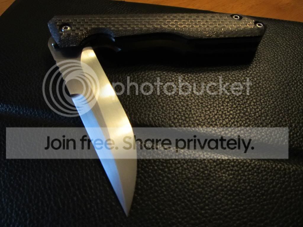

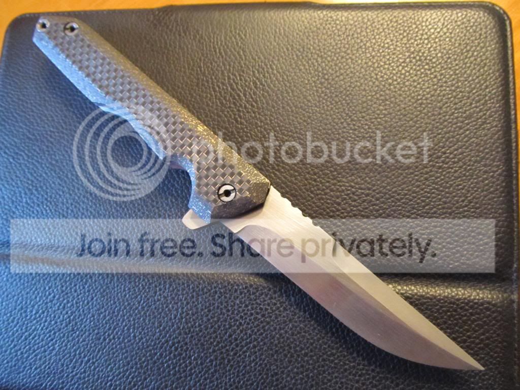

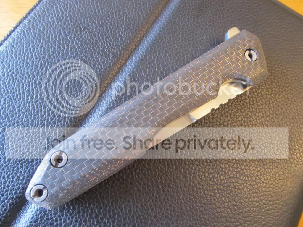

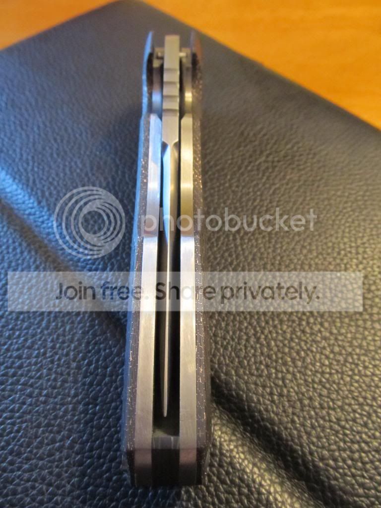

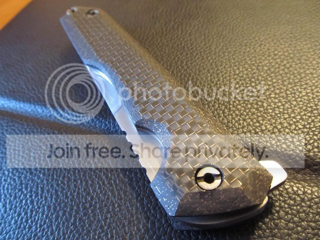

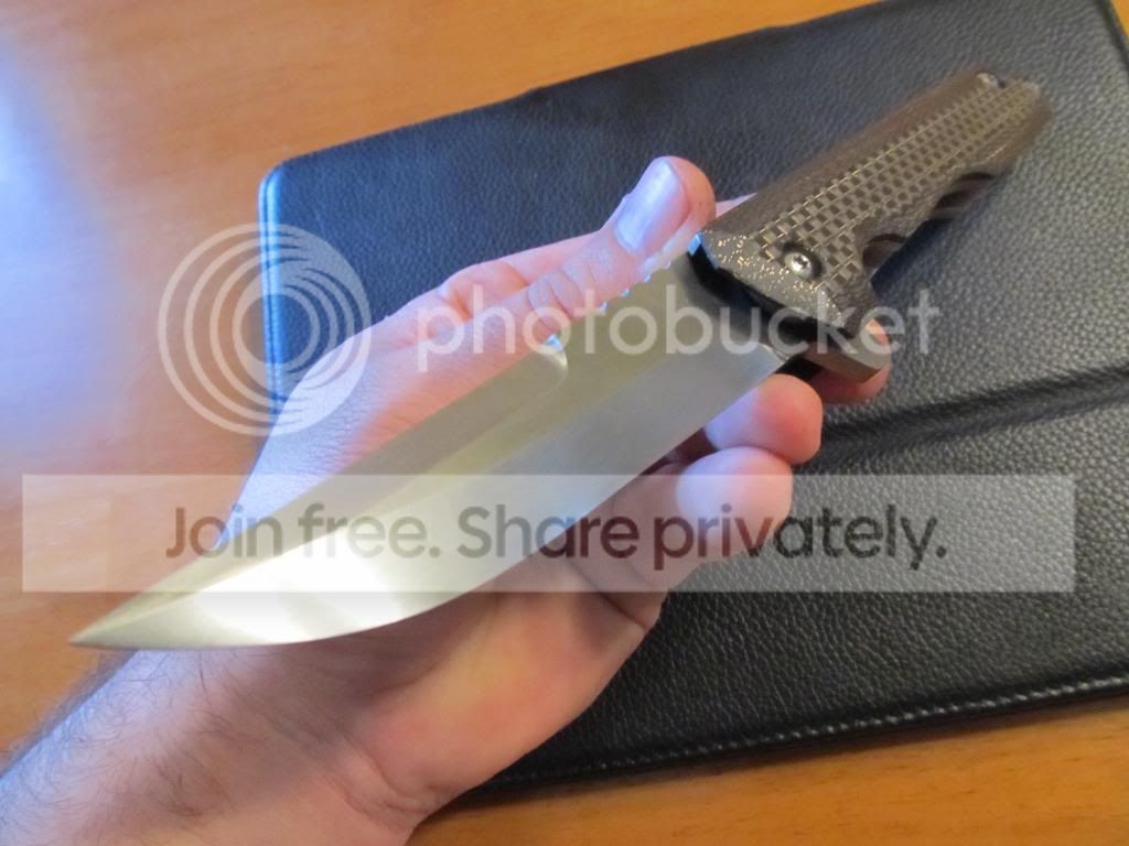

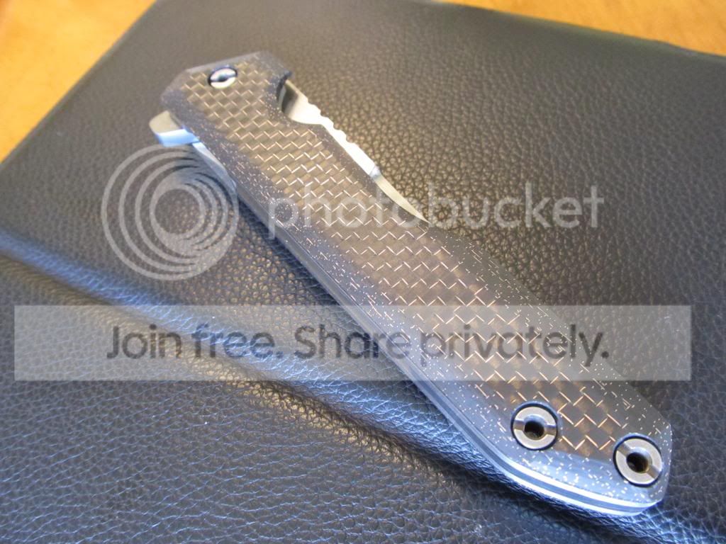

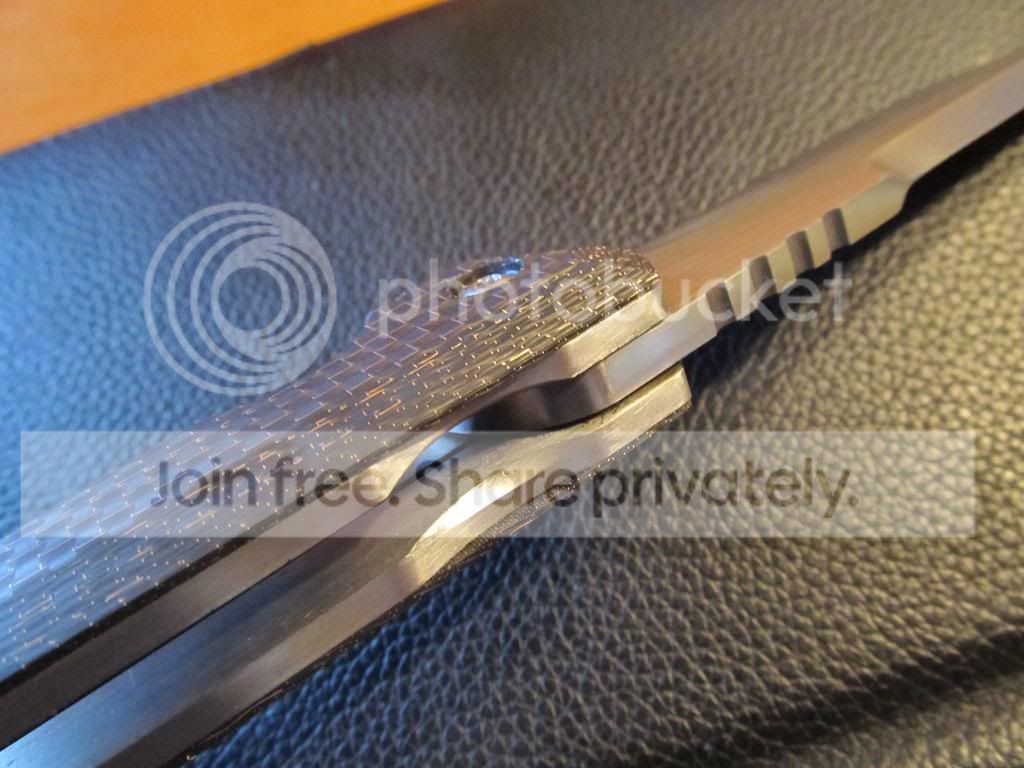

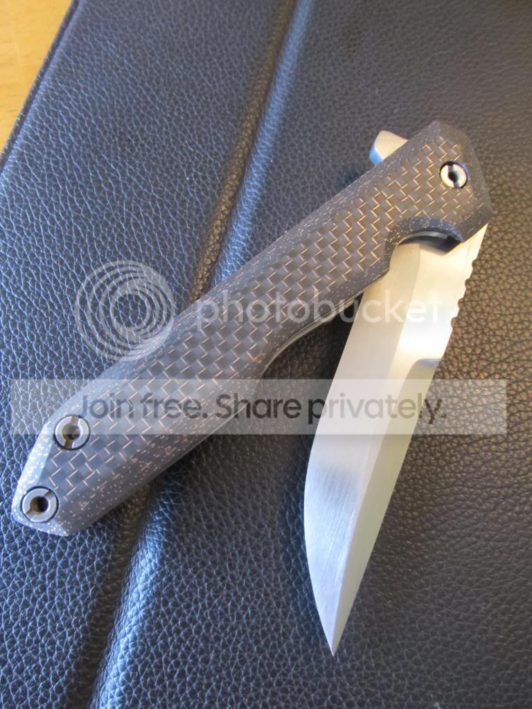

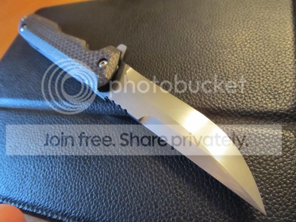

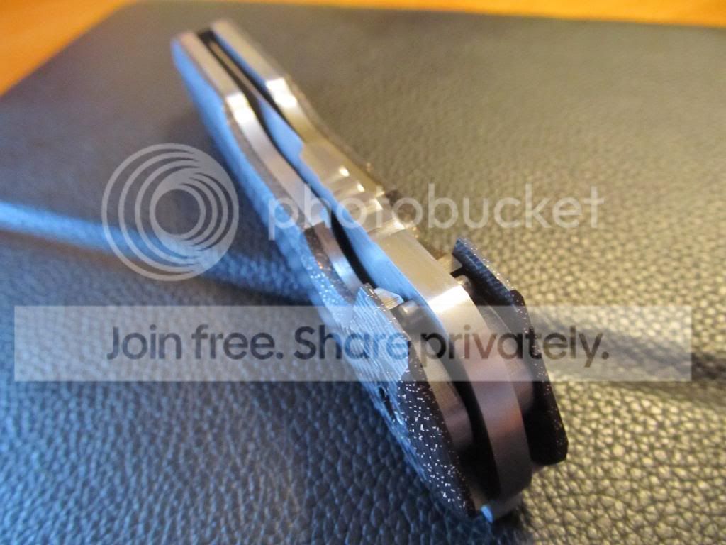

due to the 17 billion requests i get every day for a flipper design, i decided to hunker down and make it.
this will be my flipper for the next little while.......
5.5 closed
4 inch blade .170 s90v
.125 ti liners
lscf scales
GTC bearing system (thanks for the help gus)
* The run im doing now has s35v and .100 ti liners.
* this is pre ht and rough. i havent even drilled the detent yet....i was too escited to show it!
Very cool! I really like how you recessed the liners at the front of the handle to cover the stop pin on the blade- very slick. :thumbup:
Great lookin' knife Peter. I'll bet it wasn't easy to design a knife that size and have it flip easily too.

I really like how it doesn't pretend to be anything but a flipper. The stop pins are recessed, and aren't available for thumbstud opening, hidden all throughout. Almost a katana/weehawk combo, plus bearings... My favourite Canadian maker, almost in my backyard... sign me up. Screw my knife budget I talked about earlier, this is one of the few I must have.
I've been wanting to design a blade like this for a couple months but haven't been able to find the time, plus the logistics of organizing such a thing seem difficult at best. Only thing I could ask for to improve on this are deep hollow grinds, but that's not a biggie (If you like Peter... you can try your hand and i'll pay extra!)
