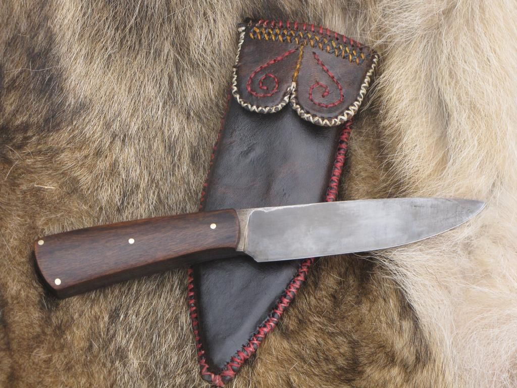

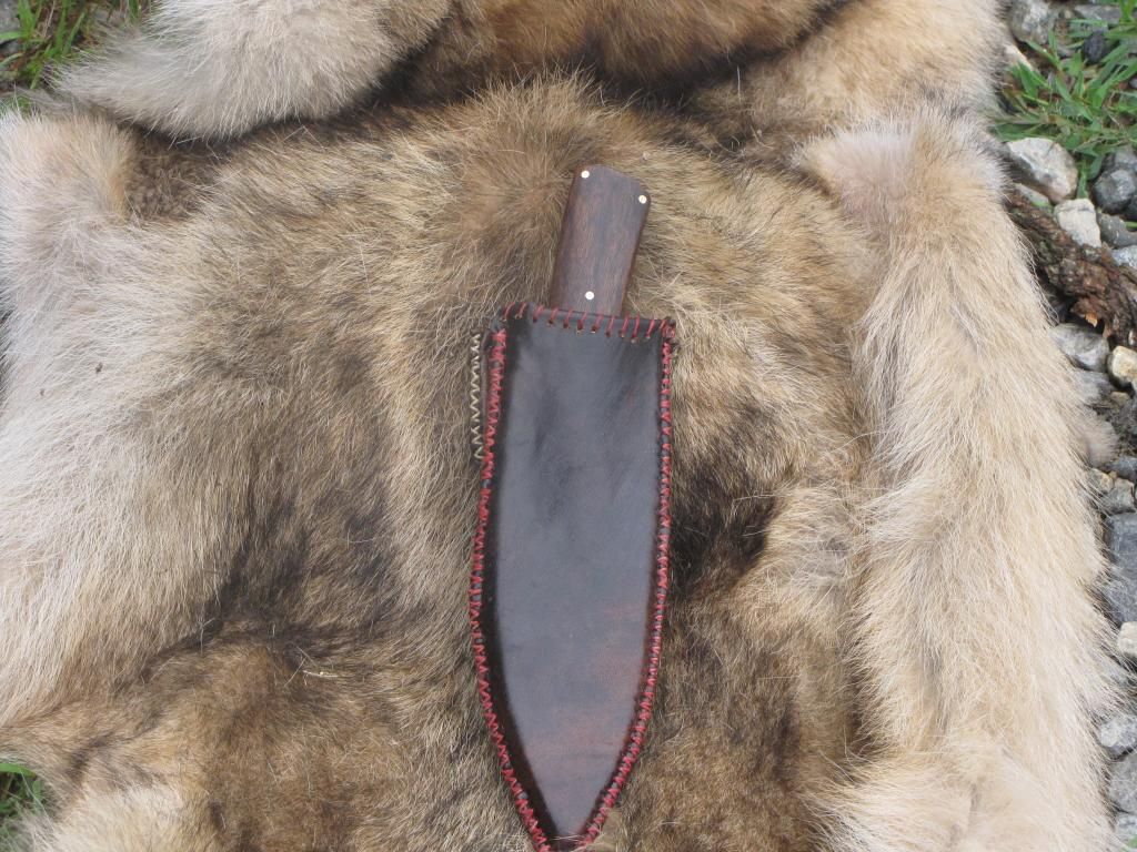

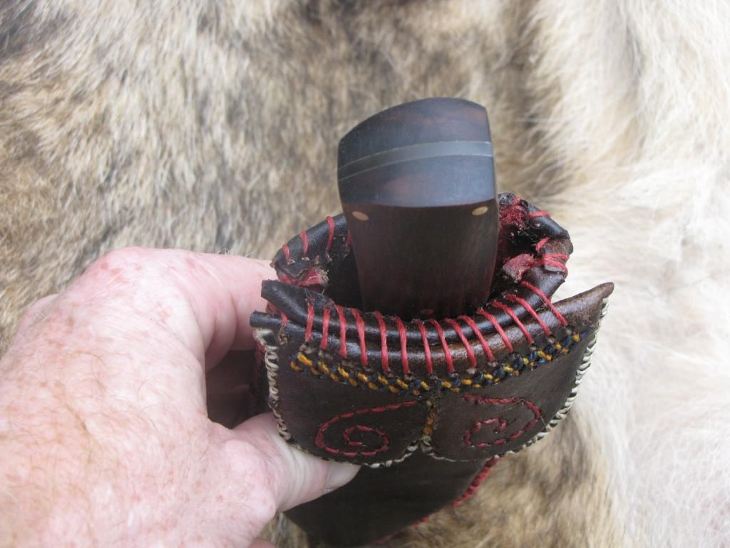

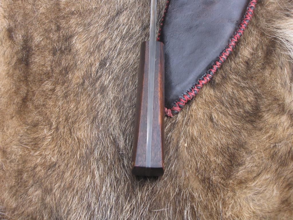

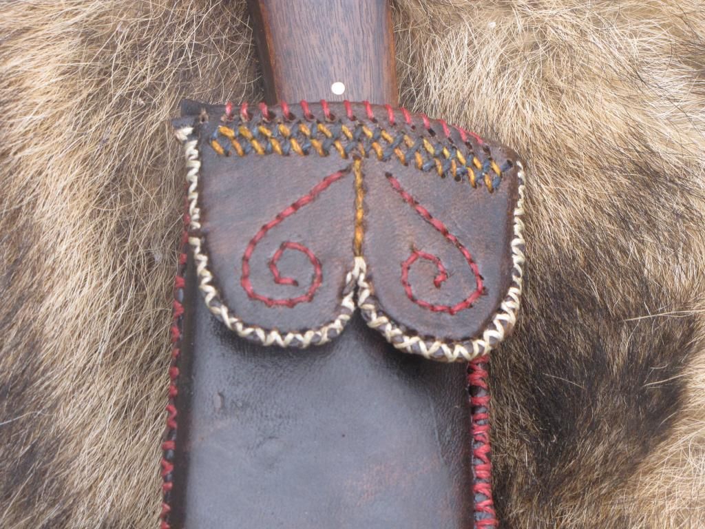

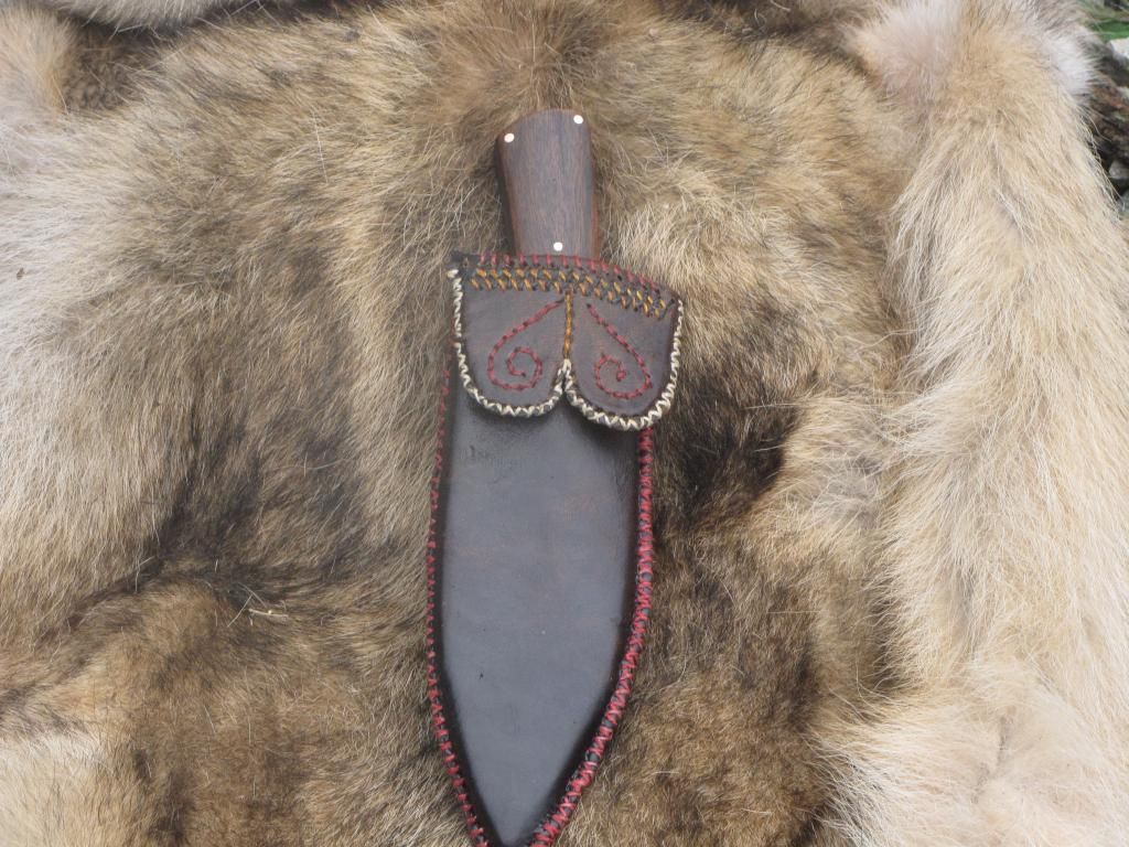

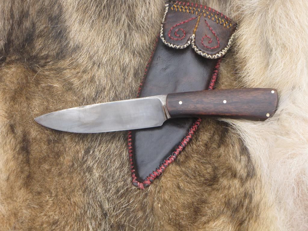

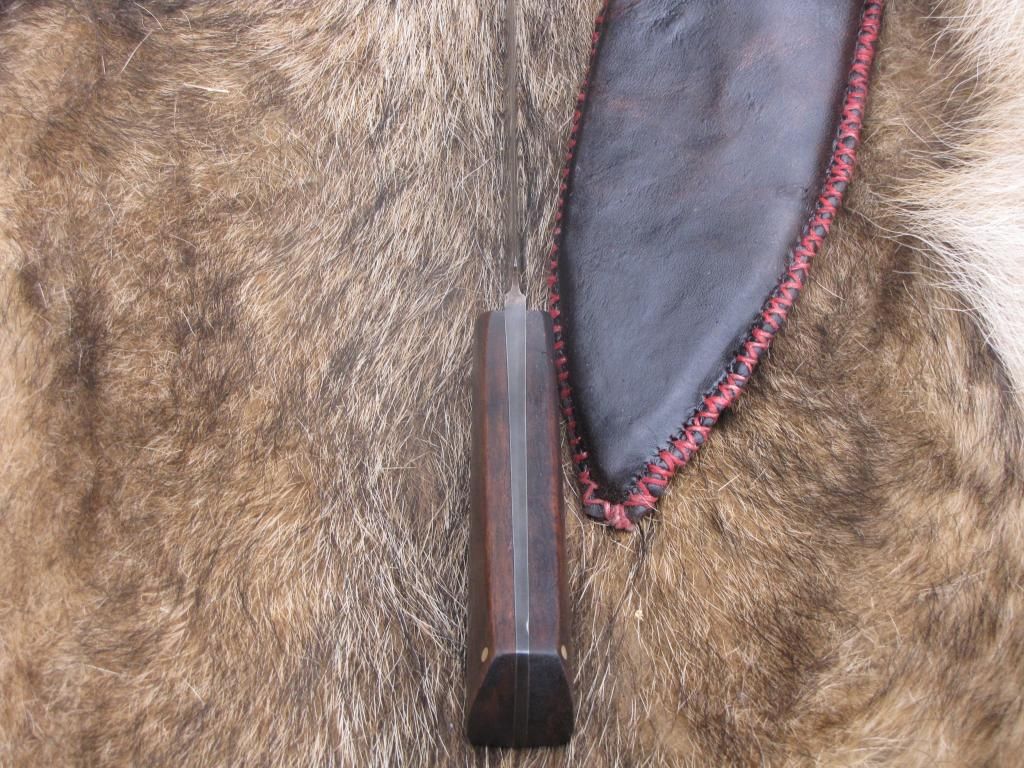

After reading The Frontiersman by Allan Eckert I wanted to make a knife that Simon Kenton or the like would carry as those guys are the original American Buscrafters. I forged it a couple of months ago and just now got around to finishing it. It is forged from 80CRV2. The blade is a little over 5 1/4". It is flat ground with a convex edge. The blade is 3/16" thick directly in front of the handle with a nice distal taper. The tang is slightly tapered as well. The balance point is right at the first pin. Handle is 4 3/8" with stabilized Brazilian Tigerwood that I treated with ferric chloride to give it an antique look. The blade has been etched. The sheath is deer rawhide that I made and lined with 7-8 oz. vegetable tanned leather that is fully welted. It is designed to be worn inside the belt. The stitching on the sheath is dyed linen thread. This knife performs great.
I did not add my maker's mark to the knife to preserve authenticity but it can be added no problem.
