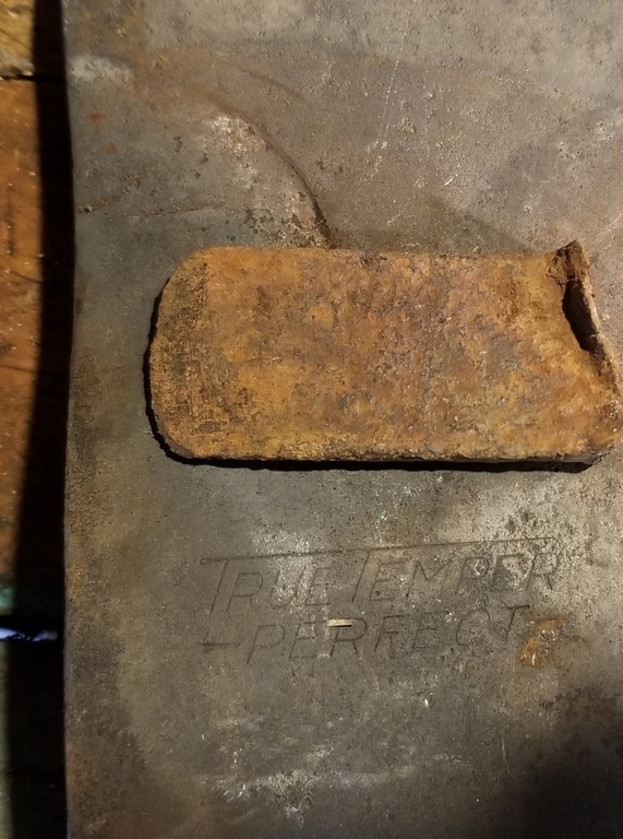

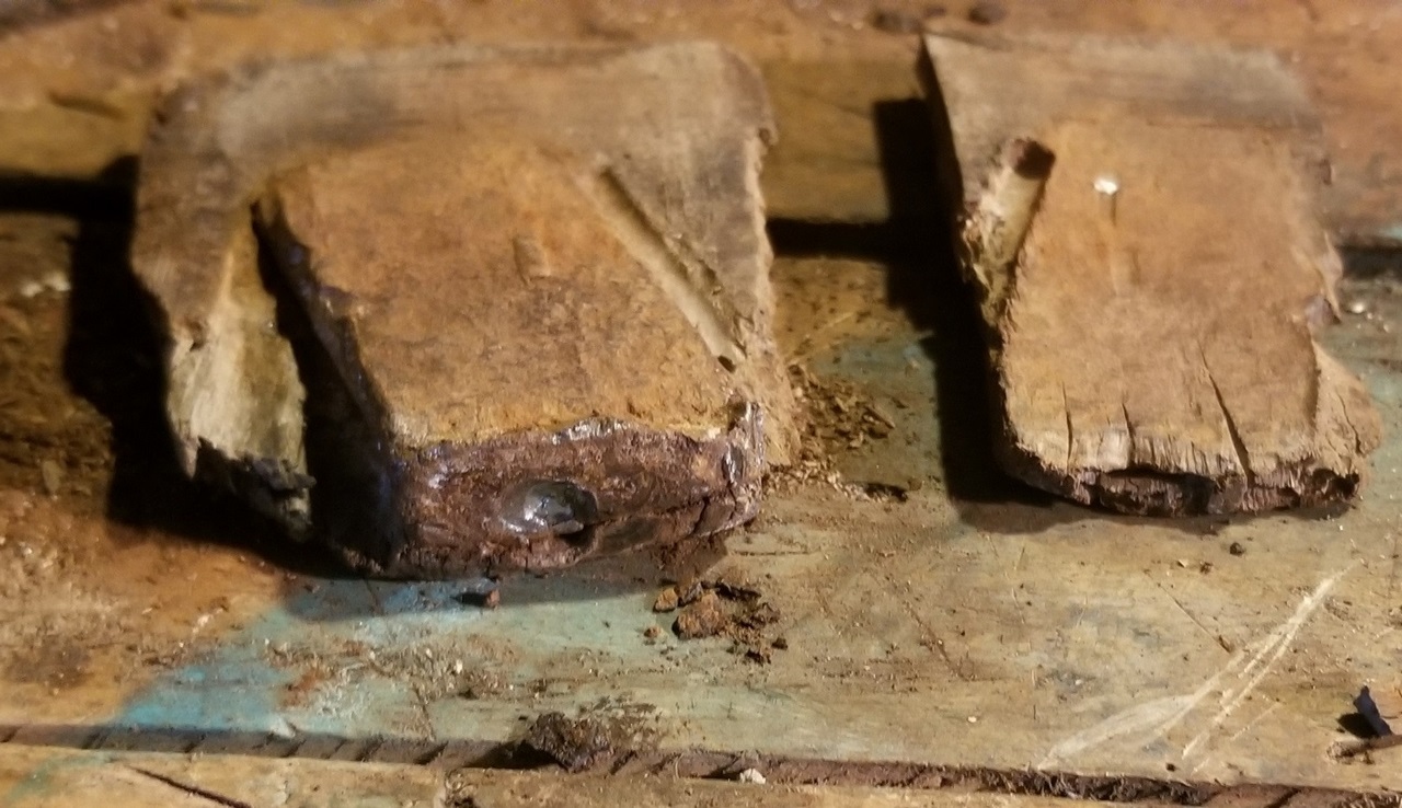

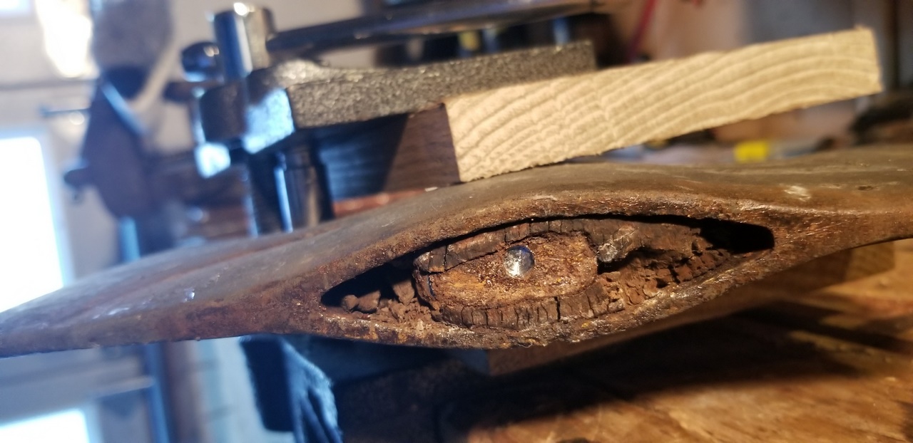

I thought I'd share this here. Made the most sense to me. This is sacrilege I know! (I used a grinder to remove the bulk of the mushrooming)(please don't tell anyone). Haha. I couldn't help it! I'd have been there a fortnight filing on it. A quick before and after and then some progress pics.
It still required a lot of filing for sure. But the grinder did save me probably 4 hours of filing. Here's a few more before and then a few after filing.
And then my final step, other than waiting for it to rust so I can wire wheel it, was grinding everything with my sandstone wheel.
I've been wetting it every time I see that it's dried and it's already quite rusty. Once I get it totally done it'll look nice I think. Have a great evening!

I agree about the forge. Provided I could've done it without messing up the stamp, and supposing I had a forge, I would've done it with heat and hammer.
I don't use chalk or anything else. I just use large 10" or 12" double cut files(i.e; nu-cut, and or flat or mill bastard) for the grunt work and then switch to a grobet inox 00 cut file. The latter cuts very, very well yet makes small enough filings that a rap on the bench and quick sweep of a brush cleans it.
And I'm not sure what you mean about training the file? Do you mean how much experience I have filing? If that's the question many dozens of hours filing on many dozens of axes! Haha. It's the extent of my metal working due to my current lack of a forge so I really enjoy the work. I have a fan blowing on me and a headlamp on and I'll just stand there for hours at a time filing often late into the night.
