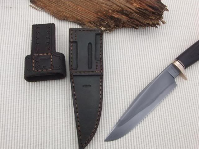

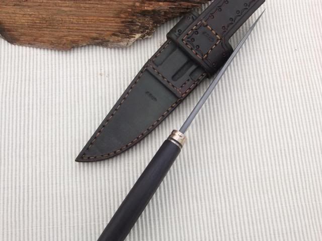

Let me add a bit about the sheath. This was my first attempt at making a sheath with a frog and a button stud. I think it turned out pretty good and everything fits nice though Paul Long I am not.
The sheath itself actually has a loop stitched on the back so you could carry it on your belt without the frog. I borrowed the idea for the loop from one of my revolver holsters that has three slots in it. You use the left and middle slot for right side (strong side) carry or use the left and right slots for left side (weak side) cross draw, or use the loop to lash to your gear if you want. Its pretty versatile for carry.

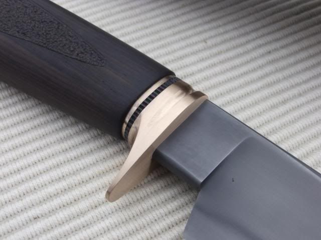

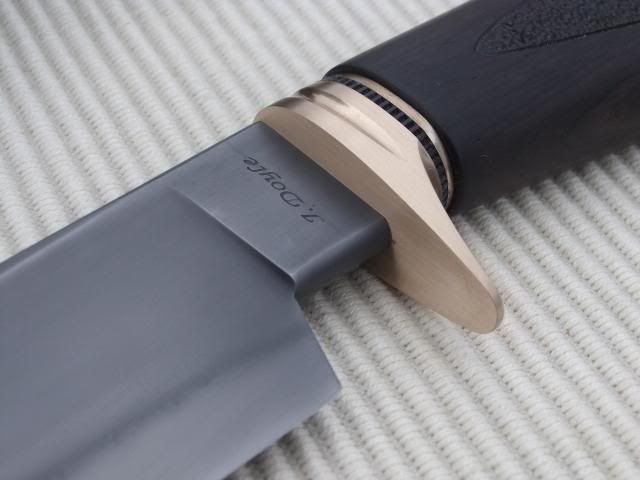

So here it is.
Forged from 1080+ steel (which I think should be named something else as its quite a bit superior to 1080, IMO)
Just a shade under 12 overall, 6 ¾ tip to guard, 6 1/8 sharp
.210 at the ricasso with a really nice full distal taper
Rounded spine and ricasso edge
False edge, not sharp
Bronze guard and spacer
Coin-edged and blued steel collar

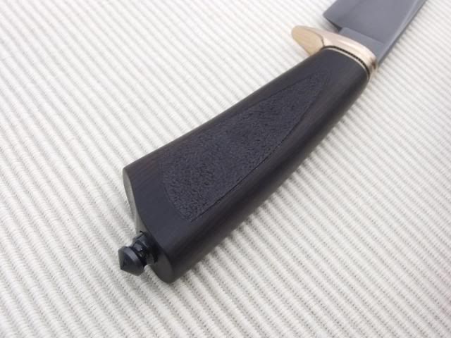

African Blackwood handle with carved and textured panel
Blued steel finial nut (made using John Whites machining methods in the Old Glory thread, Thanks John!
