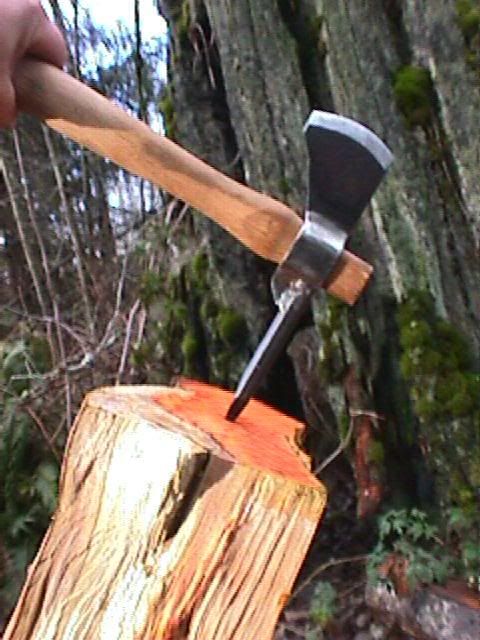

Hey, fellas.

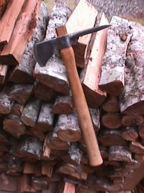

Fairly new member here with a firewood tool to show you. It's not as pretty as yours, kinda hillbilly engineered, but it sure works well when I'm getting in the winter fuel. I'm thinning my woodlot and there's probly 2 or 3 cords of blowdown out there from storms this fall and last winter. Many of you know the usefulness of a pickaroon for handling firewood and small poles. I've had a few pickaroons, and I'm kinda partial to long-hooked ones. After a while, you can hook a round, move it to where you want it, and sort of twist your wrist to drop it.
Well, sometimes my rounds sneak through with a sucker branch or staub still attached, and I don't want to fire up the chainsaw again, so I combined a hatchet blade and a pickaroon to create the... Hatcheroon!
My buddy Gary did the welding (I suck at welding) but I made all the parts - a busted cold chisel ground to a point for the spike, a flattened piece of pipe and the blade is a chunk of leaf spring.
Maybe I should call it the "hawk-eroon" because it looks more like a tomahawk than a hatchet.
Here it is doin' the job...

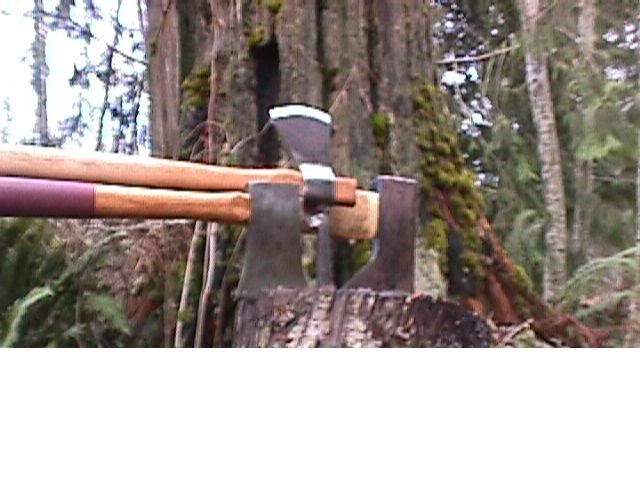

A family shot with a Collins 2-1/4# camp axe and a cute little trail hatchet that I inherited from my dad and rehandled.

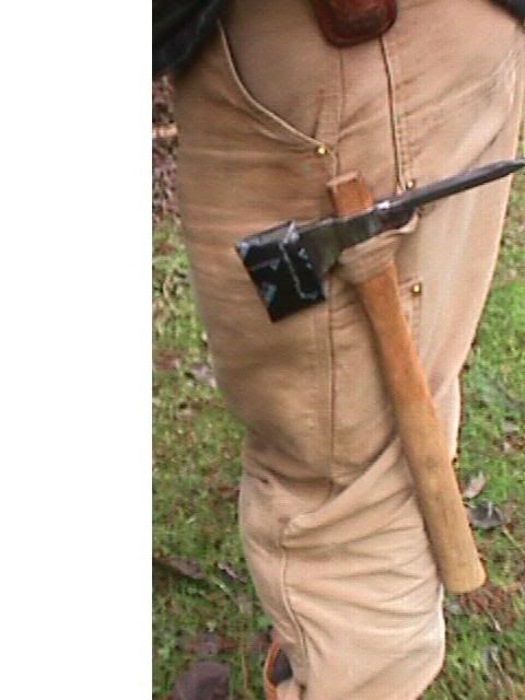

Here's how it rides, complete with handcrafted safety condom made of duct tape (I meant to make a leather sheath for it, but ahhh, pressing seasonal obligations keep getting in the way).
Anyway, there it is - built for comfort, not for speed. Sure comes in handy in the forest and on my ATV.

Very nice. I'm gonna have to make one of these. What size steel pipe did you use to flatten for the handle to slide into?
Wow, Vector, you've got some cool hawks of your own!
Dwain, it was a chunk of steel pipe I picked up at the scrapyard, with just slightly over 1" i.d. I thought about leaving it round, as I've seen some hawks, but I didn't want the head rotating on the haft, and I didn't want to pin it.
That handle is just a regular framing hammer handle, and I put the head on my vise jaws and drove the handle down in there until it wouldn't go any more (no slot or wedges). I did slop it down pretty generously with boiled linseed oil, around the head part. Been through about a cord and a half of firewood so far and no sign of loosening, but if it does my plan is to beat it down on there some more. It's a pretty tight fit now, though.
