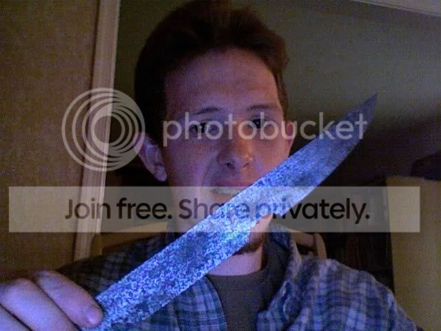

i forged out this bar of 7/8" W2 from "Sunfishman" and made this beatuful tanto blade... big... straight and strong... or so i though.
i clayed to hoping to get a nice choji hammon on it.. (and for i know i did) but it bent the blade to the left slightly... so i normalized it and went back and did it again... i let it soak a little longer int he forge this time. and it bent again!... so i tried to straighten it (becasue of the soft back) but it was too much torque on the edge and i took a chunk out of the hamon
major badness... as it had taken a week of work (i work and go to school) to get it finished...
anyway... my question is would having the blade on the left side of the forge (of of the flame) would that heat one side hotter and therefore make it bend? or was it just... something else? how can i avoid this in the future?

Anything you do different from one side to another can cause warping ! If you want to straighten the blade do it at 400 F or higher .

What Mete said. Try a forge like Don Fogg's where the blade is not in direct contact with the flame. Barring that, try using a pipe, capped on the far end, in your forge when heat treating--it will help even out the heat.
John
Man, that's a bummer and part of the learning curve. I get little to no warpage because like mete said I do the same to each side of the blade through out the whole process. Like John said also, Don Fogg style forge is tops for heat treating, very even heat on the blade from underneath and the point can stick out the back door. When I have to, I staighten blades right out of the quench, you have a few minutes to do so and at this time the blade is very easy to bend but be careful not to over bend, I wipe the oil off with a rag and holding with welding gloves, I bend straight with my hands and sometimes over my knee. I rarely have to do this but used to a lot years ago. Also over heating the blade can cause warpage. Practice, practice, practice :)

Tough luck Chris, good advise above. What's the pattern in the blade? Almose looks like a "W" pattern. May just be crude and scale, hard to see in the photo.
Ok, so Mete you indicate to try and take the curve out of a blade at over 400 degrees, and Don, you say to do this after the quench. Usually when I've taken any blades out of my heated Brownells super quench, it's at maybe about 150 degrees or less. So would I then heat it back up to the over 400 mark before attempting a bend? Maybe I'm trying to complicate things.
Robert, we're talking about two different ways to do this. I quench in a fast oil for about 8-10 seconds, pull out and scrape clay off with a putty knife, sight down blade to check for straightness and straighten by hand all while the blade is hot. You have only a few minutes to do this. I find it nearly impossible to straighten after temper, unless I have a lot of unharden steel in the spine. I have done it in the past but have also broken or cracked blades. With a water quench, I would think you have to straighten after only a 3-4 second quench then back into the water, work fast.

you asked if it was a "W" pattern... i am not sure what you are talking about.. all i did with the blade after it came out of the quence was took the clay off..

From the looks of the missing piece of steel I would suspect there may have been a crack there before you straightened it. Welcome to the club! With as many blades as I have made stuff like that still happens but not as frequently. You need to get back on the horse and try again......

W pattern is a damascus pattern in wich you cut and stack to form bend in the pettern resembling W's. The scale and clay on you blade almost make it lok like damascus.
