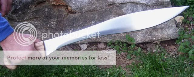

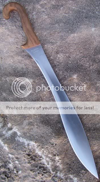

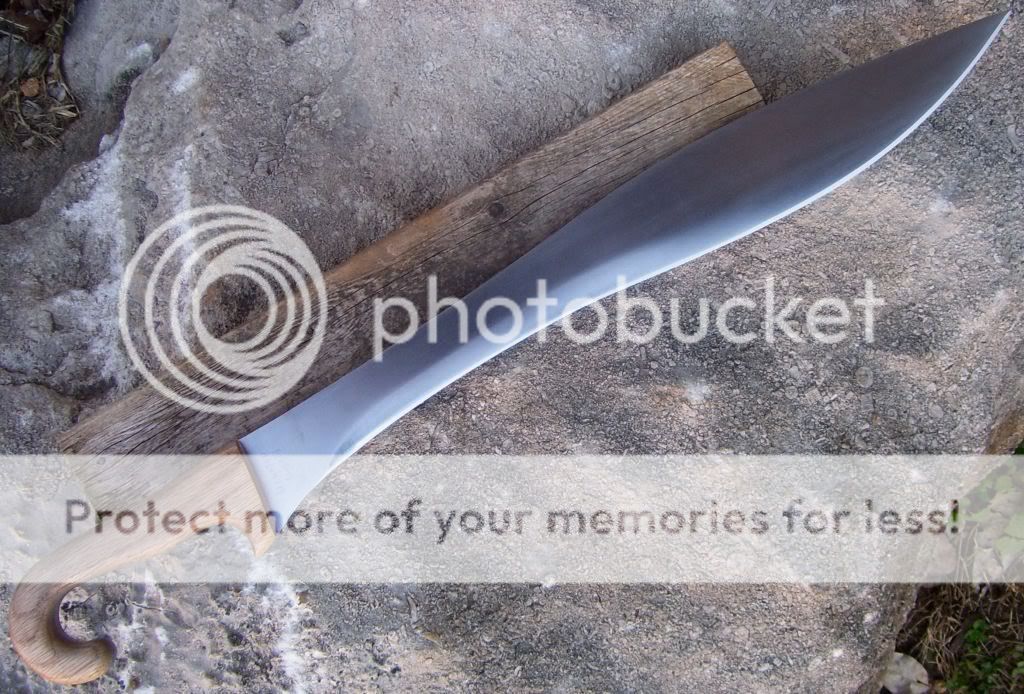

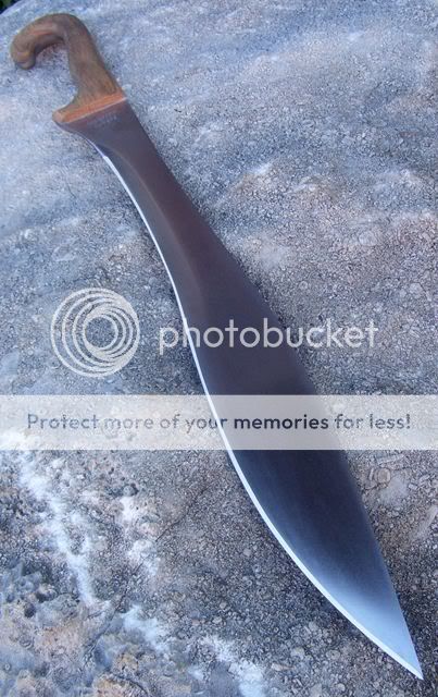

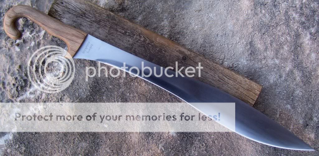

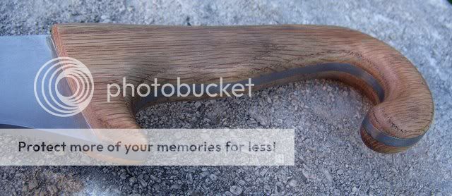

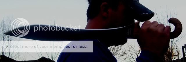

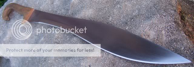

Hi guys. Finished this custom piece up for a customer this week. It designed off my Falcon Alexander Falcata, with more of a historic handle. We will be adding this one to the web site soon.
The Historic Falcata Sword
Shop Details:
1095 Spring Steel. We Heat Harden, heating the steel to approximately 1500 degrees, until it becomes non magnetic then quenching it in oil. Heat Tempered to 400 degrees for 2 hours, and letting it air cool. Rockwell Hardness of approximately 61.
Measurements
Total Length = 26
Blade Length = 19 ½
Blade Width = 2 3/8 widest
Blade Thickness = 3/16
Handle Length = 6 ½
Handle Width = 1 ¼
Handle: White Oak.
Weight: 2 lbs 8 oz
