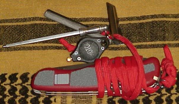

The "Hood Rig" a very handy set of tools...

1. where do you get that sharpener/steel on the cord?
As Brian already responded, it was made or at least sold by Victorinox Dealers, I have had it for a long time. You should still be able to get one.
2. is that little pieces of duct tape on the handle, or grippy tape?
That is 3M Stair Tape a friend turned me on to a few years ago. I love it. It's not as abrasive as skate tape and just as grippy. Don't even go to Home Depot or Wal-Mart, the only place I have been able to find it is at boat stores.
I would suggest having a brighter cord on the rig, in case it gets dropped...
I would take your suggestion except for the fact I already did that a week ago! I am using gutted (not real anyway) bright red parachute "type" cord, just the sheath of it. I came to the same conclusion you did. Those pics are actually a couple of months old that you see here...
ohh... and maybe add a pealess whistle
I thought about that but then I wanted it to still remain handy without having too many things banging around on it. I mean, you could put a good button compass on it as well...
I've carried a rig like this for over 20 years now, and never thought it was that uncommon. At least I know now that other folks think it worthwhile.....I keep an EzeLap pen with me instead of the Vic sharpner...
I actually carry an Eze-Lap "Pen" myself, the tiny little one that looks like half a pen, actually. For all the reasons people have cited. The steel is for maintenance and the Eze-Lap "Pen" handles a whole lot more...
Nice kit, not really sure I would like that sharpening rod "spike" dangling around my neck on my chest area. One good forward trip and now you have a little wee sucking chest wound to contend with. Just my .02 worth.
It's actually not on a loop of cord (or when it was on leather as you see in this thread). It's just tied off onto the knife and the stuff is strung on it and a stopper knot tied to the loose end. I try not to carry anything too radical around my neck because sucking chest wounds suck.

It's late and I'm tired, but just realized Don's rig also has the ceramic rod/ferro rod piggyback setup that RadioRay, who was also on that trip with, devised. Don's setup has both sharpening options.
Actually, that is the "Sparky" magnesium/tiny ferro rod setup sold under that name on some website I visited a while back.
That set up is about the good daily EDC, which I highly recommend. I carry a very similar group of items, but scattered around and not on a loop.
A good jacket with decent pockets should have all of those items as a "jacket kit" so even if you forget your normal pocket knife, you're still good to go.
Agreed. This just kind of corrals a few items together and, as I said in this post, it's not a loop, you just wrap it around the knife and then it keeps you from having a knife with a bunch of stuff hanging directly off of the end of it.
Yeah, by the way, this is not a regular steel, as someone mentioned above, this one has the raised steel portions all the way around the shaft and running parallel down it, a bit more aggressive but still just for maintenance.
The updated pic I spoke of.
Does look better...
Looks a bit like my setup, though I do have a Suunto button compass and a minibic on mine.
And a bunch of keys. :) I like this better because I ALWAYS have it with me now. My cord is about 6 inches of braided 3mm accessory cord. I forget how much cord that is, but it's more than you would expect.
