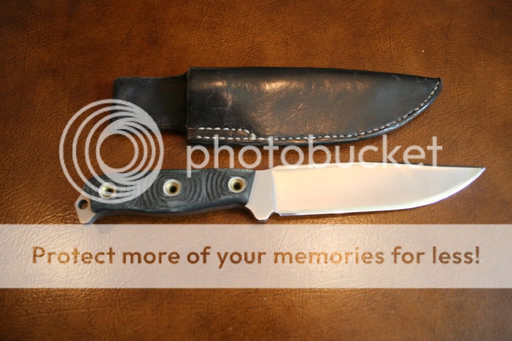

Well, I have a new knife in the 6" class. A fine piece of steel by Jeremy Horton of Tennessee. I like this knife quite a bit, so I've decided to post a brief review here for everyone.
The knife:
The blade is 6.2" of S-7 steel. As you can easily see, it has a full tang covered with machine textured then hand-smoothed black micarta slabs held very solidly in placed with flared brass tubes. The knife is 11.25" long with a handle that is about 5" long.

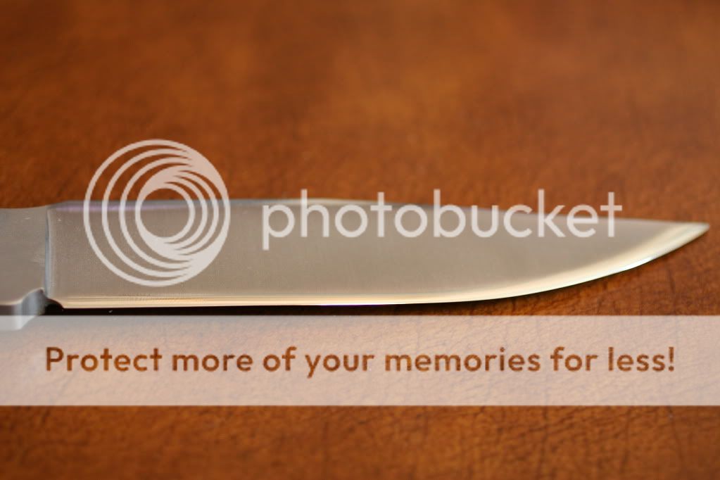

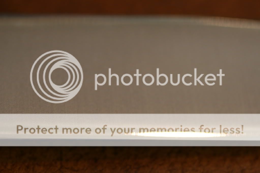

Mr. Horton only makes users, so you don't often see a Horton knife with this much attention to the polish. It's a bit tough to see, but the edge has a true mirror polish as does the area near the spine (including the swedge).
This knife has an extremely sharp, convexed edge (a "platinum edge" in Horton's lingo). The knife is much more than shaving sharp -- it will easily split arm hairs. Sorry I don't have the macro lens necessary to demonstrate this.
The knife is made from 0.30" stock, but it starts thinning halfway down the blade where the swedge starts; it is 0.12" thick at the spine 0.25" back from that sharp, useful point.

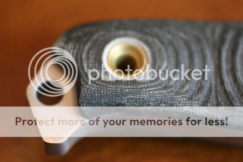

The handle is extremely comfortable -- just right for my middle-sized hands. Here's a close-up of the butt:

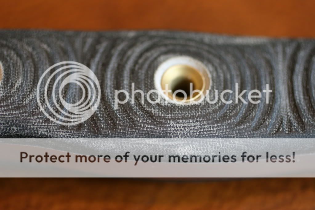

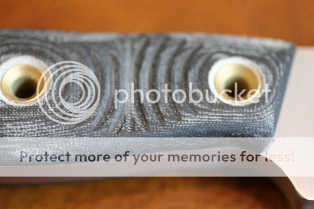

The mid-section of the handle:

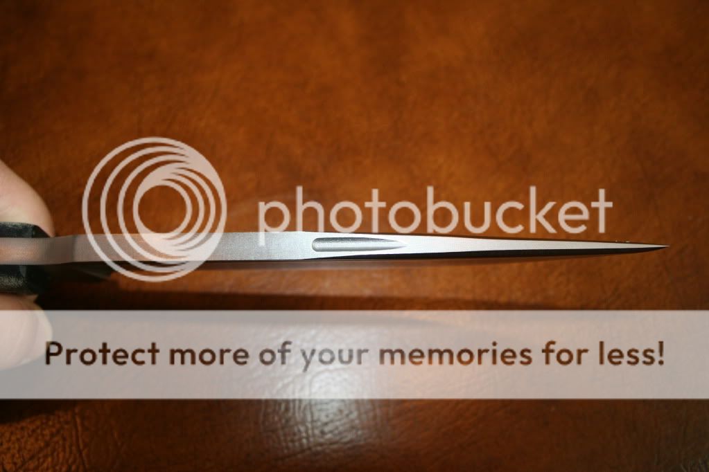

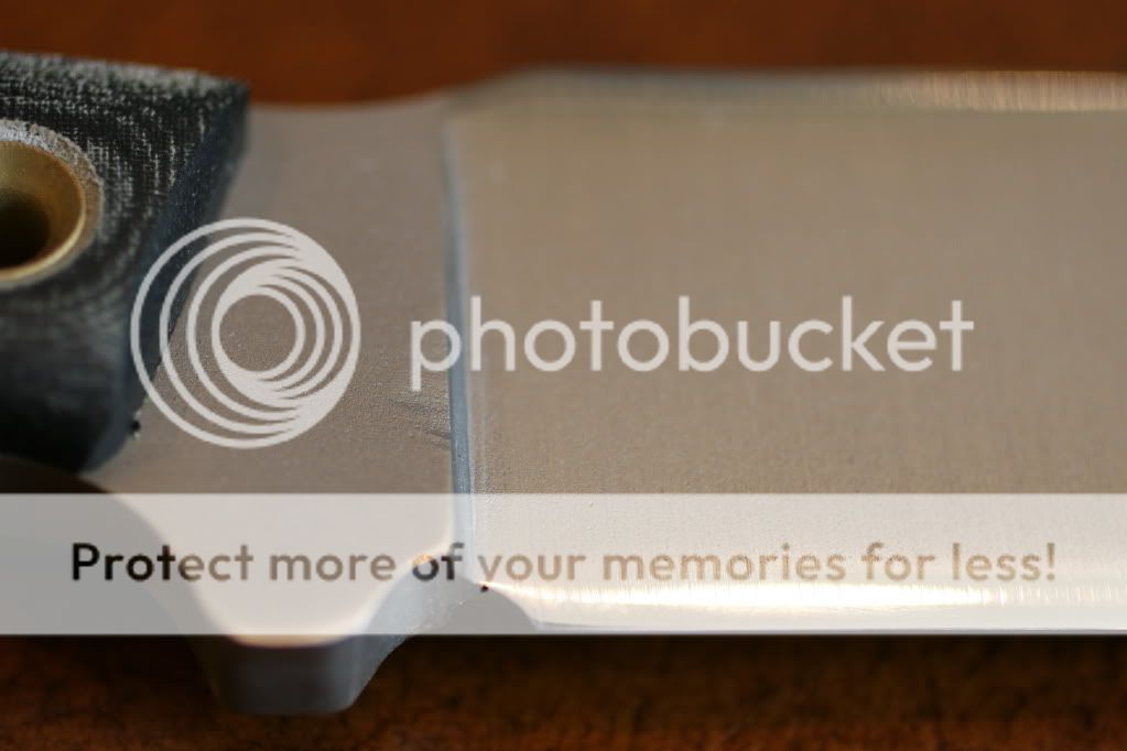

And the section of the handle near the blade:
There's little danger of accidentally running your hand off the handle and onto the blade, as there is a small guard near the blade (visible in the picture) and a nice, useful thumb ramp at the top.

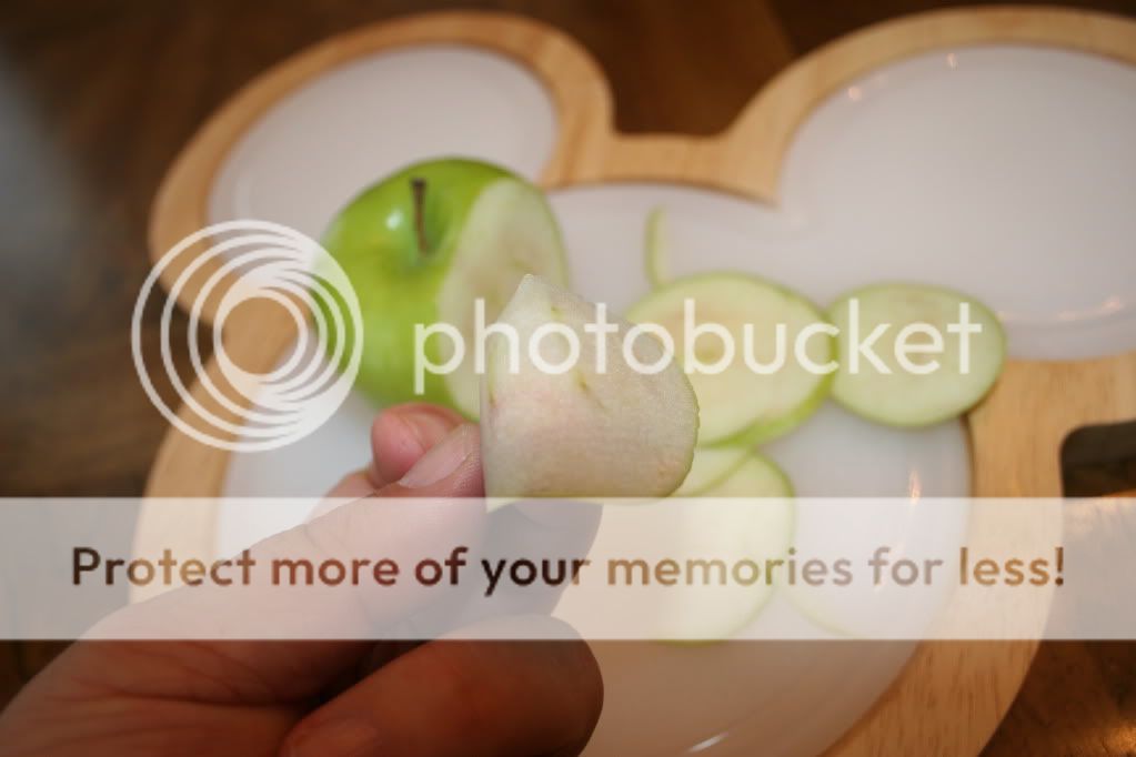

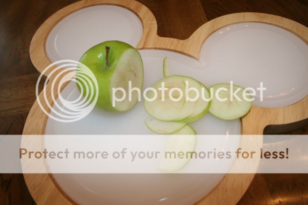

Here's an available apple:
The knife just slid right through it.

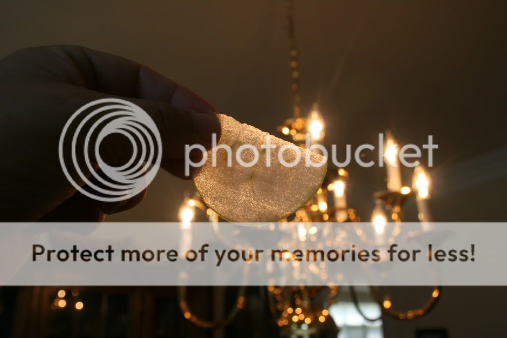

In fact, it was easy to shave the apple:
I could make arbitrarily thin slices with no troubles.
Tomatoes, cucumbers (dinner salad) were just as easily dealt with. Meat? No problem at all.

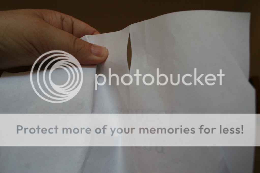

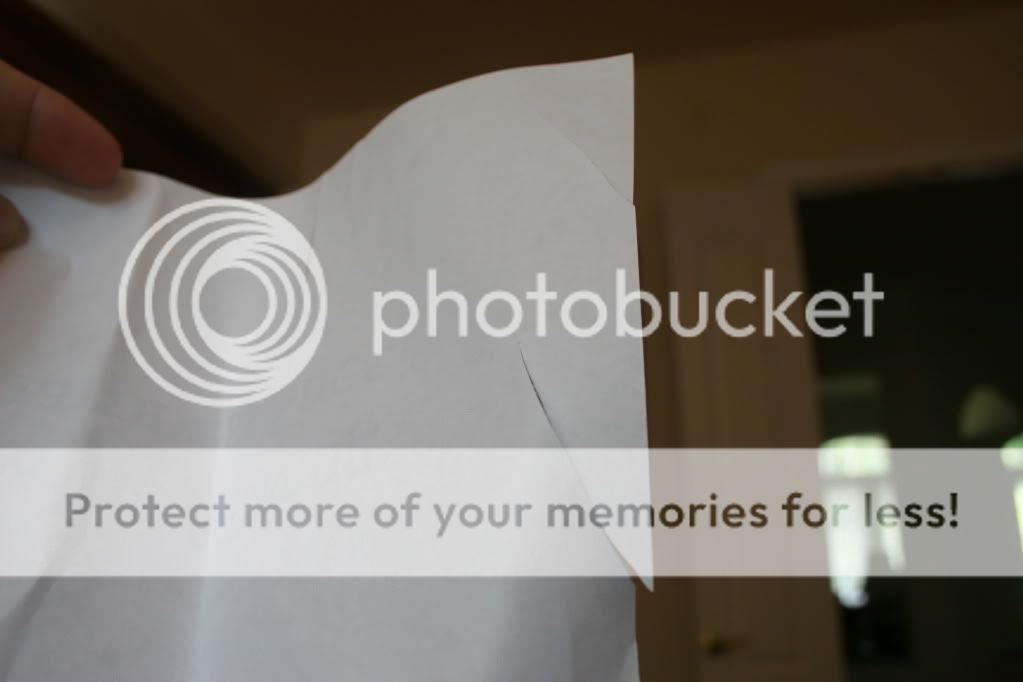

I attacked a piece of paper with it:
A push cut was no problem at all:

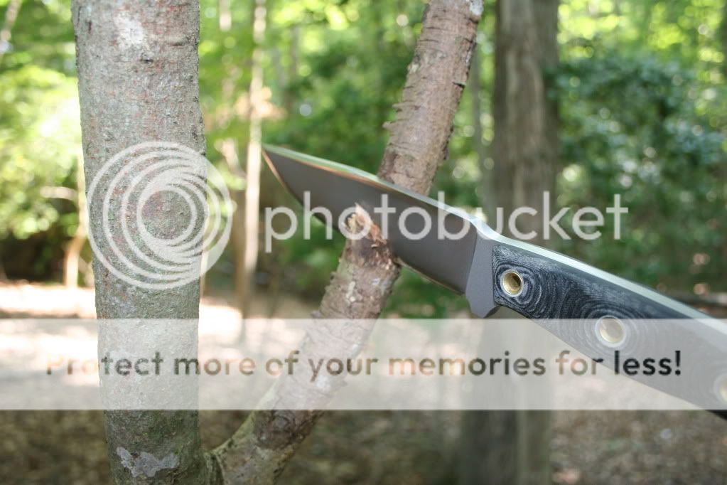

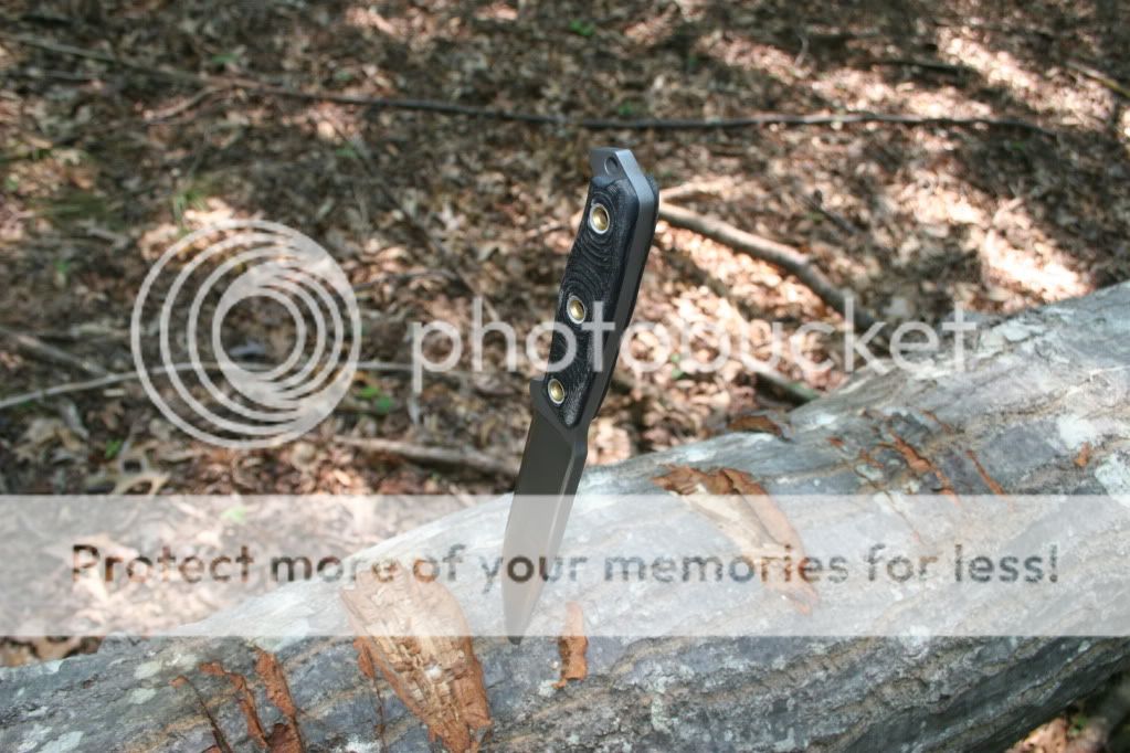

As expected, the knife likes wood:
That sharp tip is very "stabby" -- it bites right in with no trouble.
I was surprised to discover it's a pretty good chopper!
I just swung from the wrist and it sank right in. I wasn't expecting that, since it's pretty short and it isn't tip heavy (like a typical chopper). It's probably the smooth finish and that wonderful convexed edge.

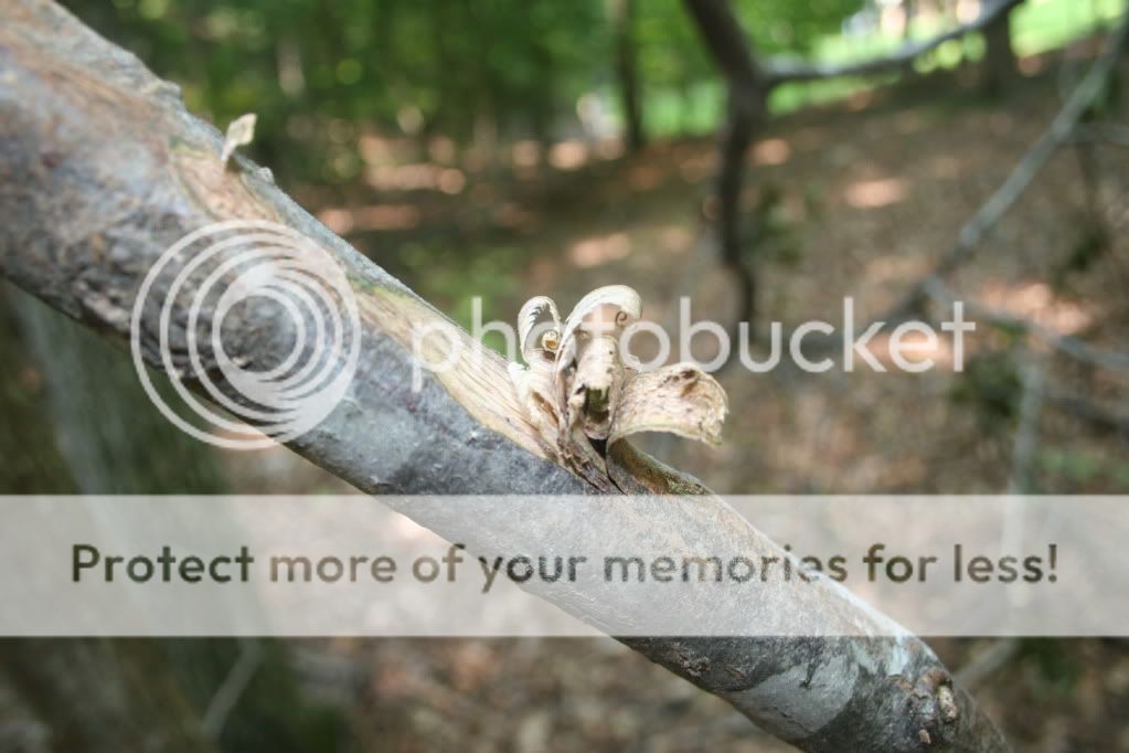

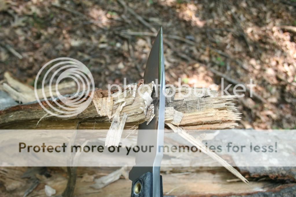

If you like to make fuzz sticks, you'll like this knife:
It's no effort at all to make wood curls.

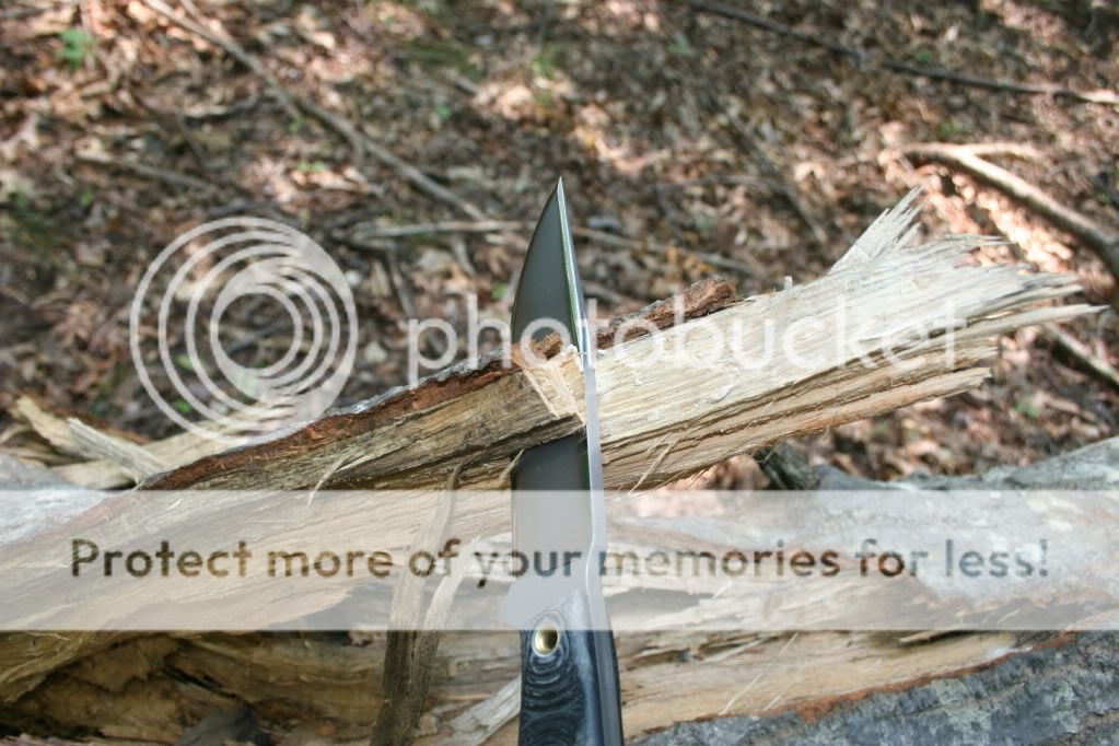

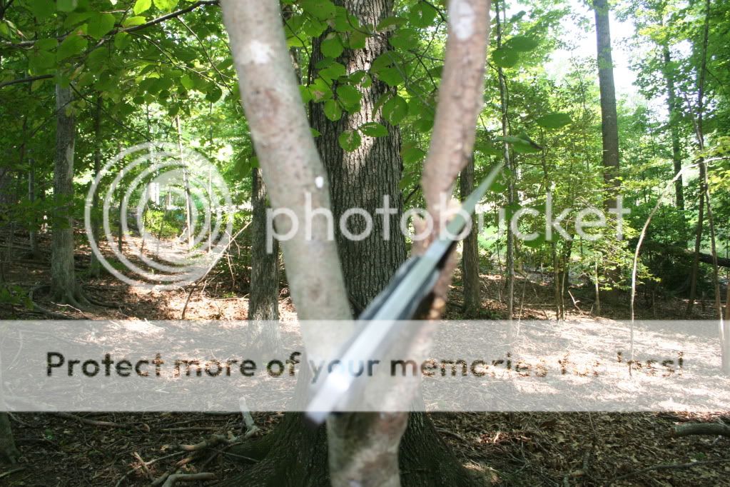

I attacked a dry, dead limb on one of my trees, using just the wrist and a little bit of elbow:
That's three swings on the left and four on the right. With good, firm swings I would have been through that dry branch much more quickly.

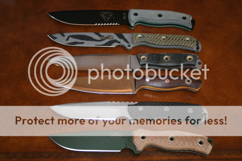

Here's a comparison shot:
That's the TS-1 at bottom. Above it is a SR Ratmandu (the only clean one I have left), the new Hinderer fixed blade, Andy Roy's (Fiddleback) outstanding Woodsman knife (all cleaned up for the pic, Andy!), one of Jerry Busse's old style Satin Jack knives, and the extremely handy R.A.T.-6.
Every one of these knives is excellent, or I wouldn't still own them. Any one of them is a great choice in the 5" - 6" class.
Andy Roy's Woodsman is, to me, probably the perfect example of the small outdoors knife. Light, handy, and able to every job but chopping. The handle is smooth and comfortable; it fits perfectly in my hand. Food prep, fire making, and general cutting are all easy with this knife, and it does hold its edge for multiple camping sessions.
Jeremy Horton's TS-1 seems to be at the other end of the spectrum of small outdoors knives. The handle is also very comfortable, but it is much "grippier" with its textured micarta. It can definitely do the basic chores, but it is surprisingly useful as a tough little chopper, too. The point is quite sharp, but also very tough -- I think it will stand any reasonable abuse I could hand out (it drills right into soft and medium woods). The edge is just amazingly sharp ... and it retains its sharpness after about an hour in the woods working on soft and medium woods. No use showing you a picture, since the edge just cleaned right up by the end of testing. I can re-sharpen a convex edge, but THIS edge just demands an improved level of expertise. Looks like I'm going to have to get some more practice!
It will take more experience, but I think the TS-1 is right up there in Swamp Rat and Busse territory in terms of ability to withstand ridiculous abuse. I can't bring myself to try it, but I suspect I could stab my way through a steel garbage can with this knife ... or reduce a few bricks to powder.
But, I'll leave that sort of abuse to someone with a different attitude toward knives. I'll just say that the Horton TS-1 is a definite keeper and is now one of my favorite outdoors knives.
