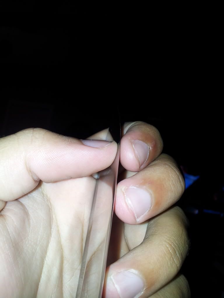

defenetly convex man honestly it does outperform v edge in everyway that i have tested. those that say it doesnt just might not know about edges and geometry yet or like some guys have mentioned here they just make it to round wich makes it very strong but lack performance bite and slicing. .heres my bk2 i convexed super lean convex what a convex should look like if u want it to perform really good. .almost cant tell when the edge bevel starts. . .i took it with me in the woods i chopped bunch of 2x4 and feathersticked all day and it was still super sharp just passed it twice on strop and was back to cutting phonebook paper in mid air. .convex man trust me
