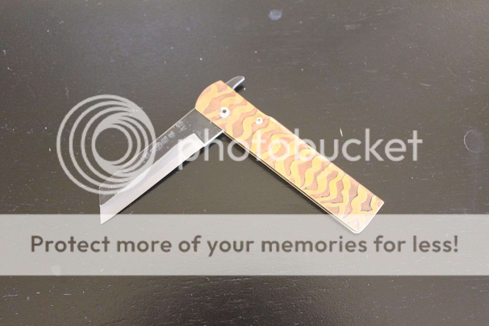

A while ago, some of you DFK faithful may recall that I mentioned I was going to try my hand at making a friction folder, with no prior experience with either a) knife making or b) steel working. I can weld, I like making things, and my basic tool skills are solid, but that's about it.
So I've been toying around with ideas, and decided that the simplest approach to an all metal folder would probably be a traditional Japanese higo nokami style (a style I love - I own 5 from varying makers, with a 6th en route).
Yesterday, I decided to pull the trigger. I asked Daniel if he minded much if I post a thread for help/progress/frustration here in his subforum and received his dubious blessing, so I'm committed now!
I bought a 6x6" sheet of copper (1/8") and a bar of 1095 (3/16") (also a 10" bar of Elmax, for no other reason than I really, really like the way it looked and felt once stone tumbled on my ZT 0561 :p). I'm going to use my Takeda Bichu-no-kami as a basic very simple pattern.
The idea is going to be a stout, probably shortish higo nokami with a tumbled, acid etched blade and a patterned copper handle.
So now comes the important stuff. Most of this will be hand filed and worked. My "grinder" is an 4-1/4" angle grinder held in a vise (don't laugh, it gets worse). I don't own a really decent set of files, so if you have a favorite brand, I'm all ears. I'm thinking a tanto type grind, single sided, but don't really have a clue how to achieve that...
Below is the knife this is will all be (very roughly, as Takeda is a master and I'm a 100% complete floundering hack) based on. Should be good times! I'm going to invite you all to share in the comedy/tragedy that is sure to follow... :D

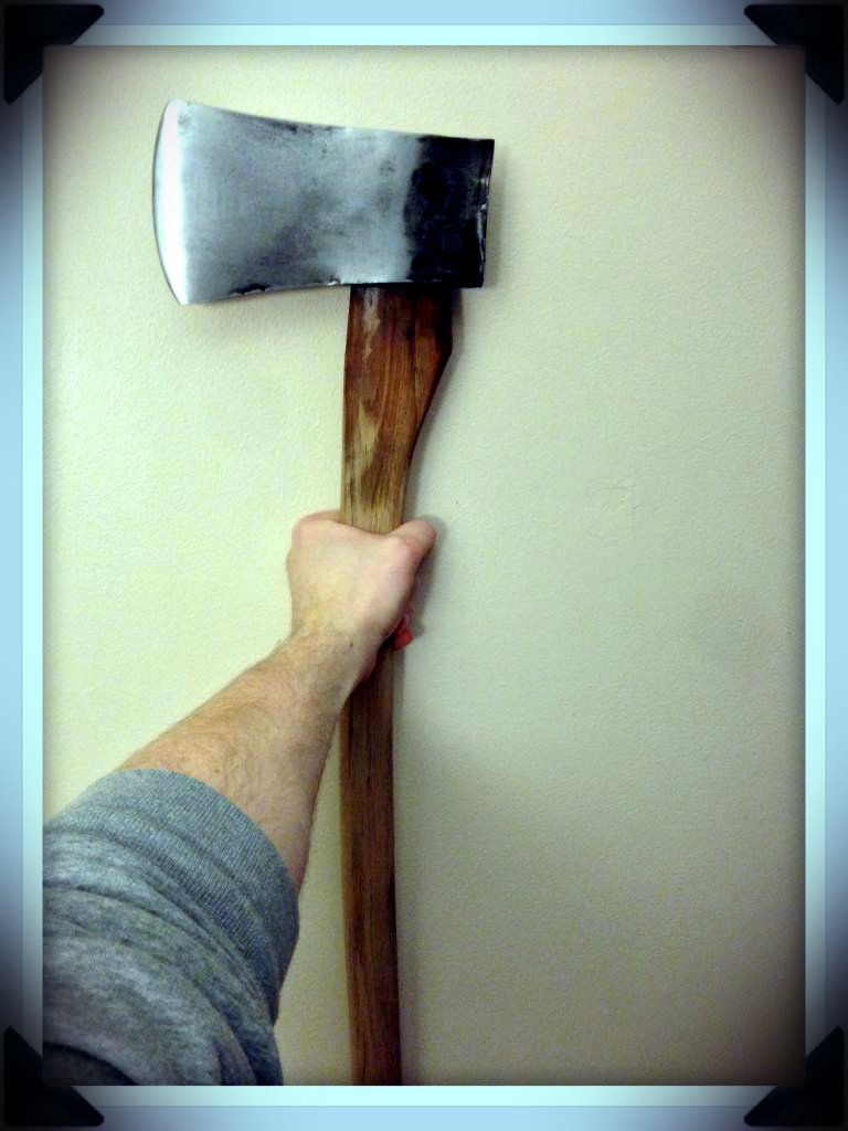

They're right about files. The very first work I did was to restore an antique axe for a friends Christmas gift. I used a single bastard file and a vice for 99% of the work. Whoa!

Nice work on the axe! :cool:
I ended up wood burning the Krampus into it. My buddy is the kinda guy that's got plenty of $$$ so buying him something is very hard. The gift was a home run, he loved it!

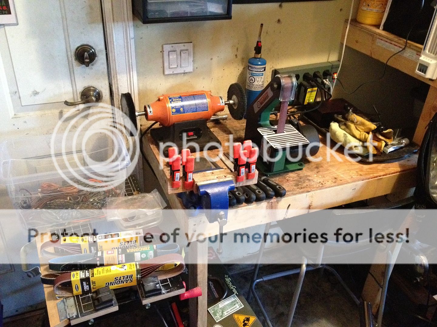

Well, not actually. Still doodling while I wait for my materials. But at least the work space has improved, with an albeit VERY cheap grinder.
Heh dude, lookin's good! Remember, everyone starts somewhere. You gotta make the best of it and add when you can!
Haha, yep. I'll drop cash on something nicer if this one takes. ;)
