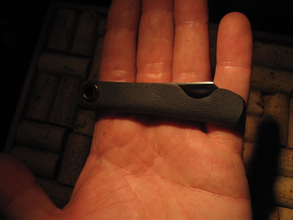

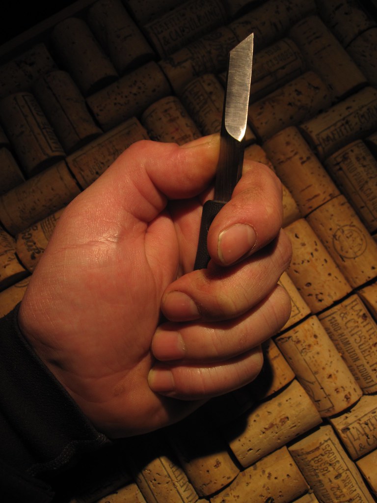

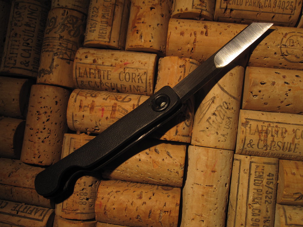

So along the same lines as the Higonokami design. I was screwing around with some scrap in the shop a while ago and came up with this. It works surprisingly well. O1 blade , .08 or maybe .09 kydex handle and eyelets for a pivot.
Wouldn't ya know it? I ground the bevel on the wrong side of the blade.:D Because of the chisel grind it has kind of a nail nick ....kind of.
Scott if you are out there ,Give kydex a try for a temporary/ test handle for your project. It will give you a good idea if things are going to work the way you want to with your design, with out a lot of work or cost.
Yes, very cool! Nice work Kevin!
Rolf I tried a SSIK folder with a milled recess for the blade... will try again on the idea.
