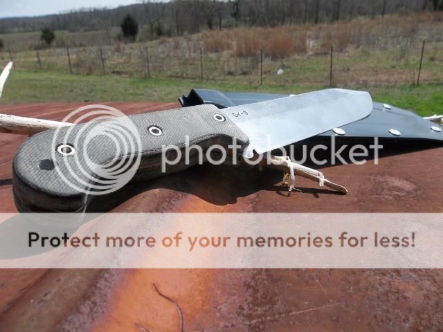

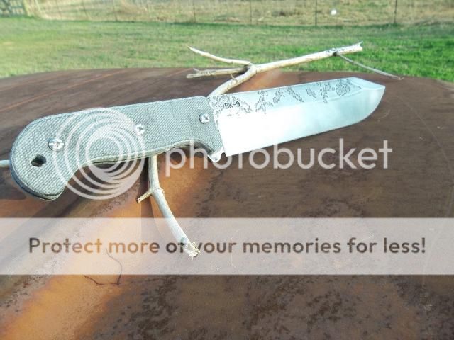

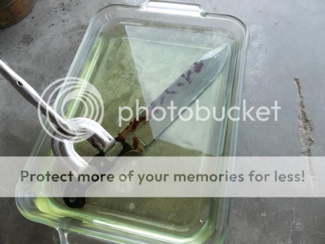

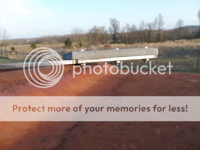

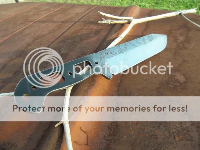

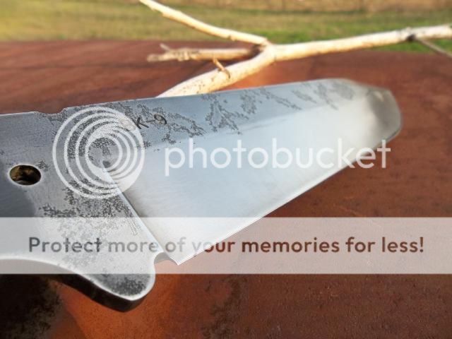

so, spent some time on my 9 while waitin on my 16...
Home-Grown Denim Micarta
Clich-Bath
Kydex

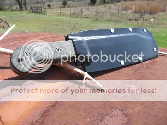

All Done (sheath is obviously Not finished, waiting on my eyelets to arrive)

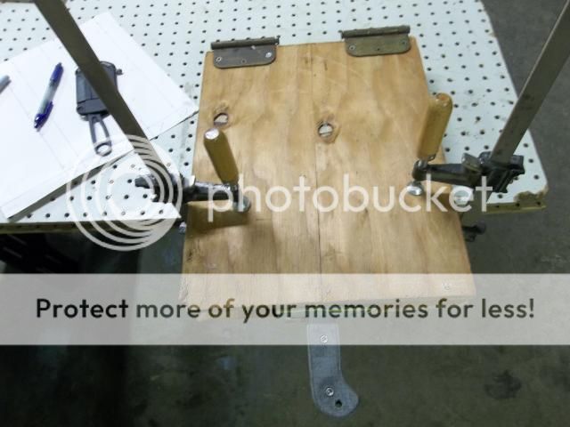

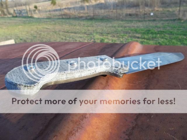

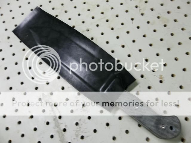

I made it. A couple pair of old jeans, a can of fiberglass resin, and a hydraulic press. Cost me about $4
Outstanding work man. Made a hell of a knife.
Thanks. Im too tight to buy the aftermarket goodies...so I was forced to make em myself. I have less then 10 bucks in the Kydex sheath and less then 5 bucks in the Micarta. I think it would be hard to find a knife package like that for under $~90 :) which is what I have in it

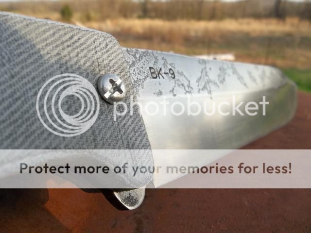

How do those new scales feel? Do you plan on shaping them at all like the factory scales?
Lookin good man, nice work!
now I know why people pay for Micarta. This stuff feels great! I like a blocky grip, I'm leaving it that way, prefer it over the factory shape. I pretty much created ESEE Micarta grips for the BK9 LOL

great sheath! you melt down some old DVD cases for that? :>
Kydex
[QUOTE/]
Is that the famous "Lost Foam Process" of Kydex forming? :D :D :D
yeah...ran around the shop/farm looking for foam to salvage for my press...This is what I found, some kinda gardening kneepad I cut in half. Apparently it's not 350degrees heatproof! Oh well, it all peeled off my kydex. :) still have zero dollars in the press LOL

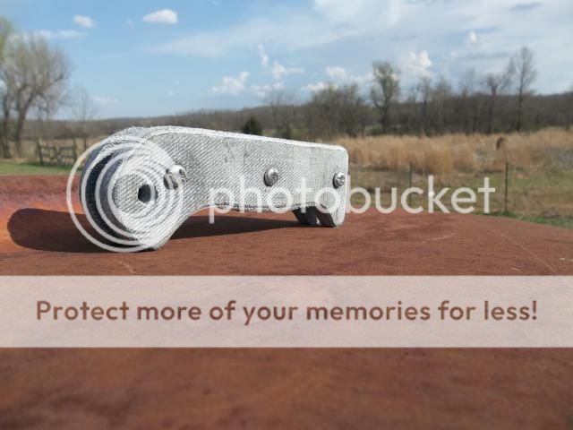

How did you countersink the holes for the hex nuts? That has been driving me crazy for a while!
Freakin' sweet! I can't wait until I try my batch! If you twist the jeans and let them set and dry like that, it makes a Damascus-type pattern; I would try it out next time you do a batch!
Im all about variety...Im done with denim for awhile, next micarta is gonna be colored LOL
well...I just used the #10 countersink bit, then used a bit just exactly the size of the hex-nut to enlarge it...then hammered the nut in. LOL works!
Im gonna 2-ton epoxy it all together anyways...just giving it a trial run for awhile before I glue it, dont want to epoxy something I may not like in a week on my knife LOL
