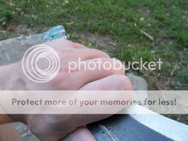

Slight mods.
Now, I just need my kydex shipment to arrive...gonna see what kinda sheath madness I can create for this sucka.
The CHOIL was Moose's idear......I blame him LOL I would never choil up a blade on my own say-so....he invoked his Mod powers and made me do it.
i like it, looks like a monster. make the choil bigger. like the bk5 then it will flow with the knife and not just be a bump in the middle
I have been looking at it since I made it...I dunno bout bigger, but I have an idea of something to ''fix'' it. i'm new to choils...first one, I don't like them LOL but on this ONE SPECIFIC blade...a choil makes sense. Kinda like how the 5 and 15 make sense with a choil.

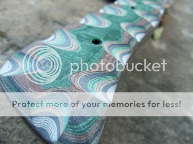

Thrill, that E-Nep is amazing. You did great, brother. That micarta looks amazing. Are there any hot spots on the handle with those grooves?
I liked the grooves on my 9..I chopped with it yesterday and I had zero problems. Its a common mod with the esee guys I guess. I haven't used this enep yet with new scales...I still need to epoxy the pins in and file em down.

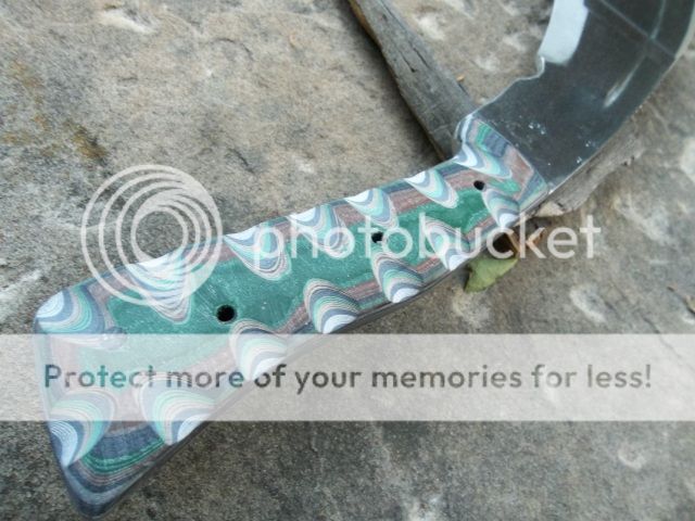

I made a booboo folks...I was making the micarta...didnt have enuff resin to make the full 60 layers like I planned (it's made from construction paper BTW) I was using the whole 9x12 sheet of paper...only had enuff resin to do 30 layers. So it's right at 3/16'' thick.
I epoxied two layers together...which put each scale at 3/8'' (same as the originals) but the epoxy failed during rasping/fitting. I think I had wax-paper residue interfering with my epoxy bond.
I only finished them to see how the colors looked final sanded...and to practice. I actually like how it feels thin though, Im gonna use it awhile, and see if I like it during chopping before I tear it apart and redo it.
Oh well, I learn from every mistake.
to give ya an idea of the thickness....the handle on the enep is almost exactly the same thickness as the BK14 with zytel...maybe a hair thicker then the 14.
