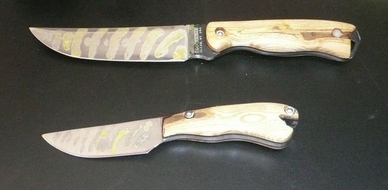

You got a pic of that modded 11?
That's awesome.
Thanks!
It was a big project.
Spacers here are .012 red and .020 black G10. The red's so thin it's somewhat transparent. Kinda wish I had just gone .030 red.
And you can see where the citristrip leaked through the blue tape on the "BK&T" side of the 15.
