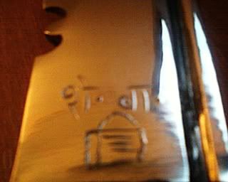

They're on the way... I'm going to take some nice ones outside. I'm having a difficulty narrowing down the kami though. Here's the reference chart I used:
http://zknives.com/knives/knimgtmpl.shtml?/images/knives/fix/himp/kamimks/kmcs.jpg
... and here's a picture from my cell phone (best I can do right now) of the marking. Who is the kami?

That is indeed Young Sher (picture wasn't showing for me previously due to poor signal). This is what Yangdu told me when I asked:
This a new young Sher Kamis mark.* He works with Bura group.
It call madal drum.
Nepali people plays the drum with folk music.
I use to play one.
I have two CAKs by him and one of them had a slight leftwards bend in the blade as well.

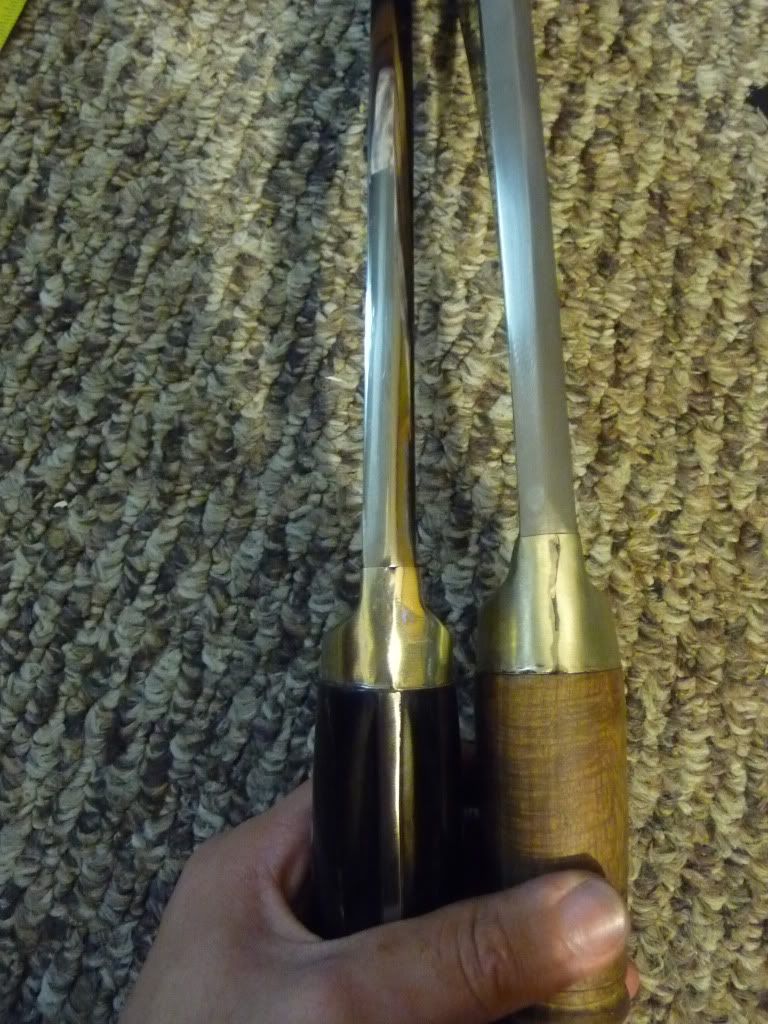

Well it's pretty wet here, and there really isn't much to chop without heading off to go camping so I can't quite comment on field-performance yet. Here's what I've come to conclude thus far however:
I don't have a good scale, but Aunty Yangdu said that it was 34oz - which seems to be an accurate measurement of overall weight... holding the two kukris by pinching the angle of the spine (one in each hand) I'd say the Bhojpure (37oz) is just slightly heavier. The difference comes when you actually grip them by the handle: the blade dynamics combined with the chiruwa construction makes the M43 significantly less tip heavy than the Bhojpure. Although similar in weight, it's like the difference between holding a 1lb stick and a 1lb hammer - the weights are similar, but the leverage causes the latter to feel much heavier. Swinging them around for practice, I can tell that the M43 recovers from a blow much quicker and will thus fatigue me less (which was the reason why I really wanted to give the m43 a go).
Weight aside, I'm very much liking the steep bevel on the m43 - I've already put a nice convex, shaving sharp edge on it and I can just tell it's capable of a nice, deep bite. Right now, the Bhojpure with it's 1/2+" spine, very wide blade, thick bevel and heavy forward weight strikes me as an ax-like kukri whereas the thinner 7/16", reasonable balance, and steep bevel of the m43 strikes me more as a heavy-machete kind of kukri...
Comparative shots + my unrealistic definition of "sharp enough":
