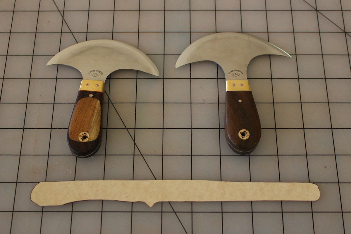

Here are a couple of pics:
Two of my non symetrical knifes and the pattern for the skivving knife. The rosewood handled roundknife on the right is always on the bench.

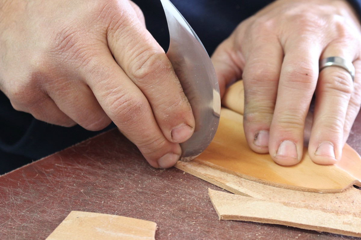

I use the short end for 90 percent of the cutting and the long thin end for specific things like straight roll cuts etc.
How I hold the round knife. Here trimming welt material flush.
Thank you Dave. When you said non symmetrical, it seems you mean barely so according to the eye. What I had envisioned was more along the lines of this.
