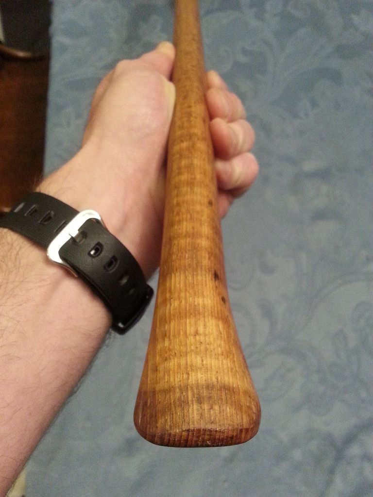

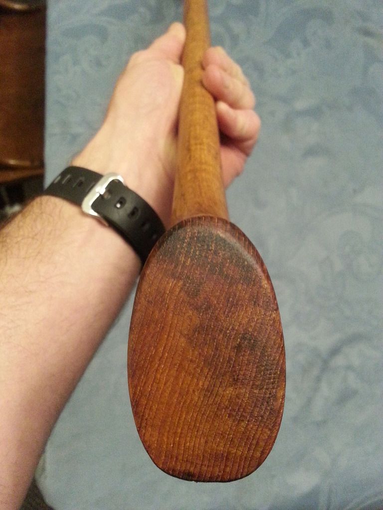

One example is evidence of nothing, but here is an older Hartwell replacement handle that's on a 4.5lb Collins Dayton. I can't speak to it's age, it was on the head when I bought it and I only refinished it. I'm not making any point, just showing my only current example.
That's enough evidence right there to say that Hartwell didn't solely make horizontal handles. Thanks, JB.

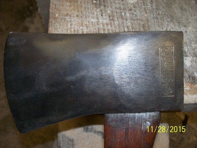

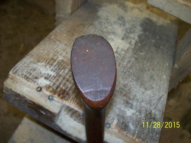

Here is another example, though. A 4 lb. Collins Dayton, but this one has the original handle stamped "Collins".
