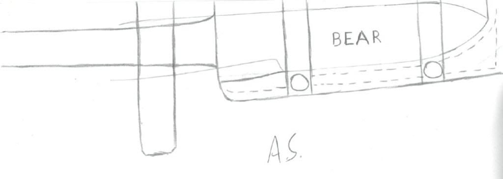

And now for the WIP of mrbear's JK Kephart sheath!
Concept Drawing:

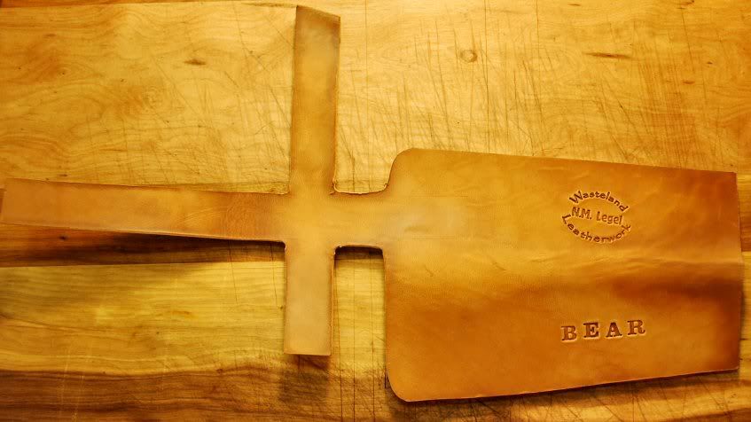

Pattern cut and stamped:
Leather textured:

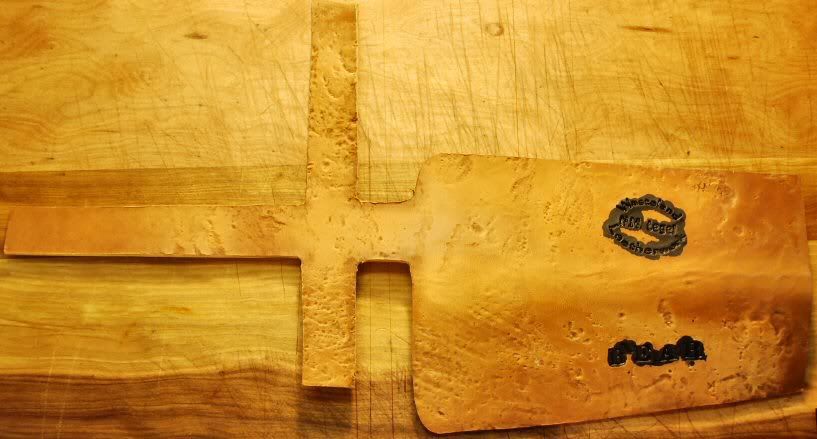

Stamping accented with black dye:

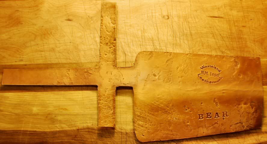

Dyed brown and single edges beveled:
Distressing and assembly to begin tomorrow!

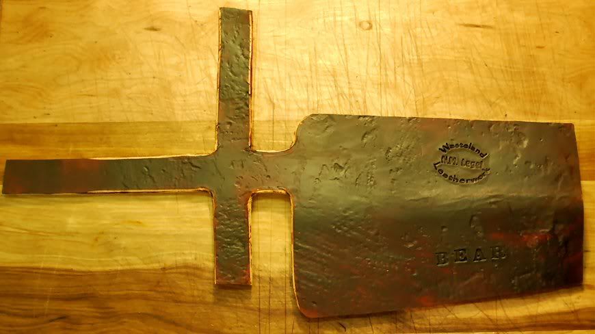

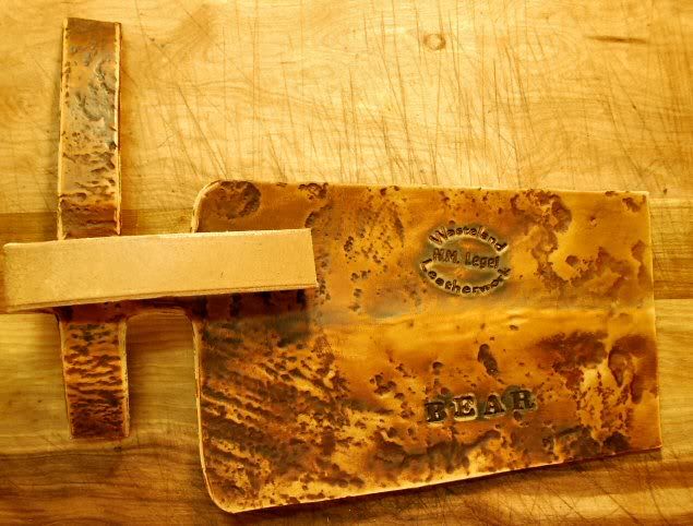

Distressed:

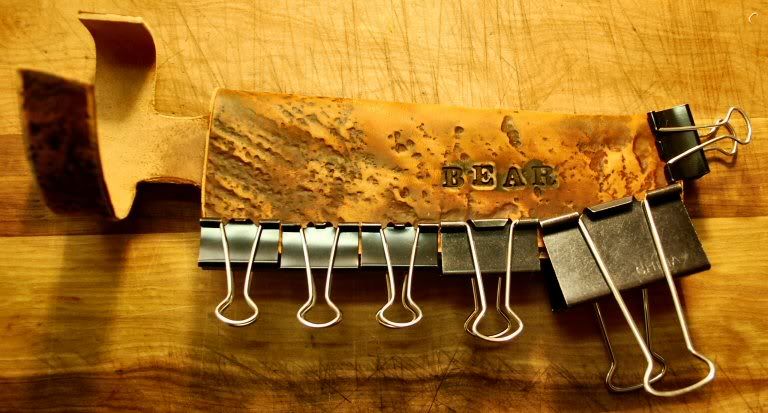

Belt loop and welt cemented in place with Barge Cement, inside welt edge hardened with CA super glue:
That isn't the final coloration of the sheath, as I have some more steps to go through before I get that. Once the cement sets I will be riveting the belt loop in place, waterproofing the interior and closing up the sheath for stitching. For now, though, it's off to Petco to do some volunteering

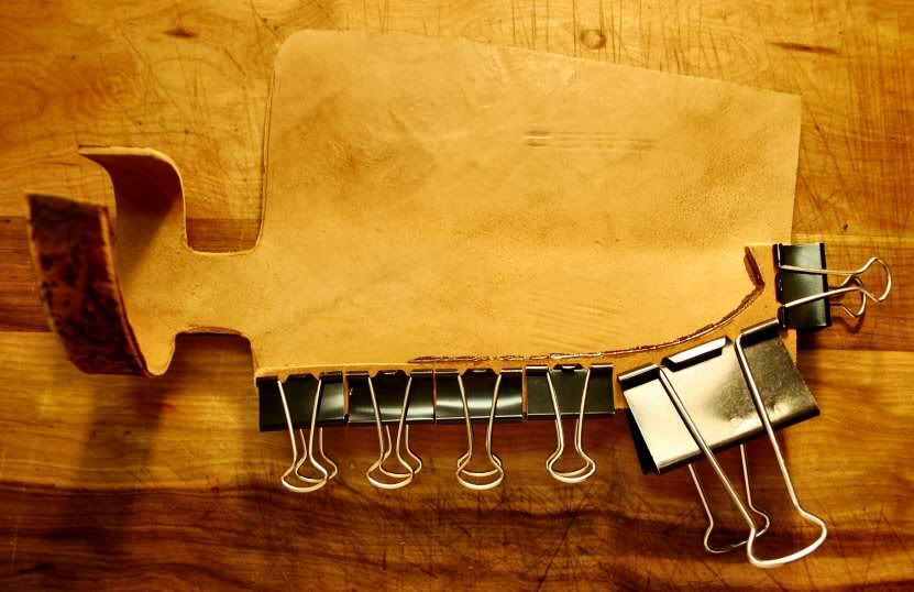

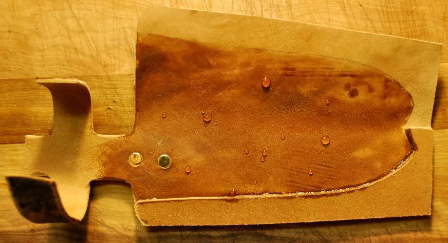

Belt loop riveted in place and interior waterproofed (I smear water on it to make sure it's repelled like it should be, and I left the droplets on to make the photo prettier :P):
Cemented together:
Once the cement sets for a few hours I will trim the edges flush, then sand and bevel them, then I'll cut a stitching groove and mark where my holes will go. After that it's stitching time, which I will probably be doing at work :P

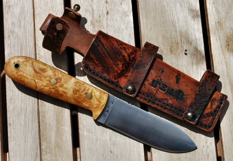

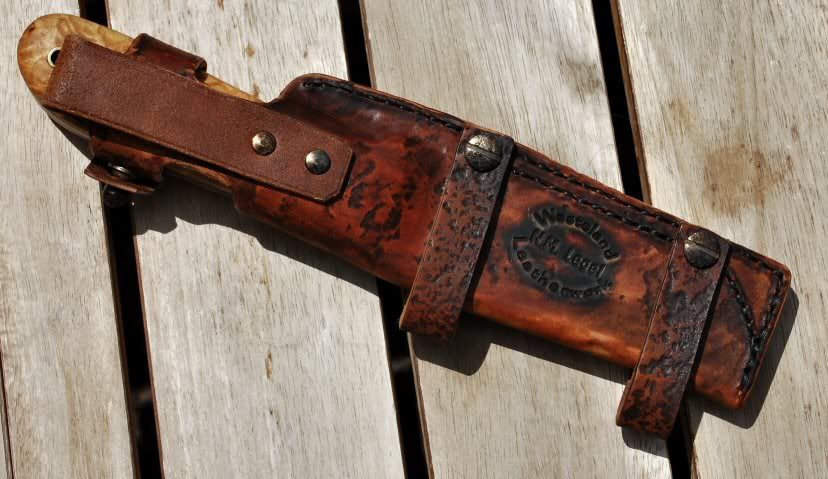

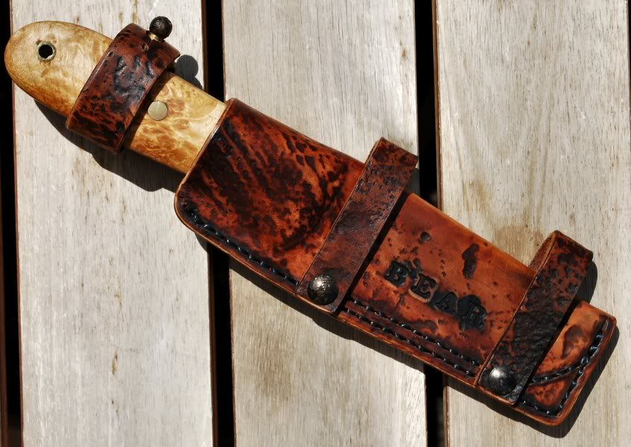

All done! Sorry for the missing steps--I forgot to take photos of them and then my fiancee stole the camera (although since it's hers I guess I was the one stealing it)
NOAHL YOU MAKE A VERY NICE SHEATH MIGHT NEED TO SEND YOU A KNIFE OR TOO THANKS DON B:thumbup:
Nice looking knife AND sheath! That sheath looks a lot like the one I have---good stuff!!!!
