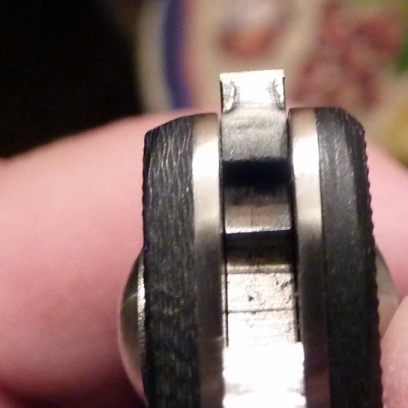

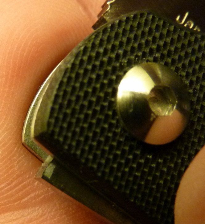

Spyderco "pinches" the lockbar on some of the Moki Japan made lock backs. It does the same thing that you are trying to do. Here's a few pics of what I mean.
The lockbar on that Farmer doesn't even look like it should work right sticking up as high as it does. I am not dogging on you but just surprised it came from the factory like that.

David and Mike thanks for the comments.
David the lockbar doesn't actually sit as high as it looks in the disassembled knife pic, check the picture directly under my caption "tonight's work" in my previous post and you can see it sitting flush with the blade spine. I appreciate the spyderco pics, I might try going that route.
