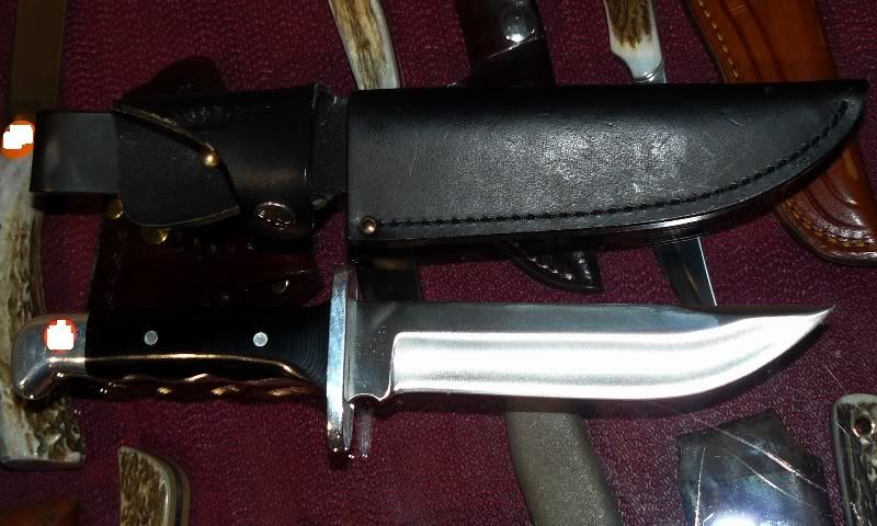

Model 124 Frontiersman, no date stamp, no wear at all on the knife, blade sharp and perfect, black micarta spot on, aluminum flawless and a tiny bit of wear, black worn off in a small area, on the sheath (no box, no paperwork):

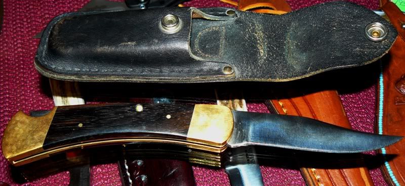

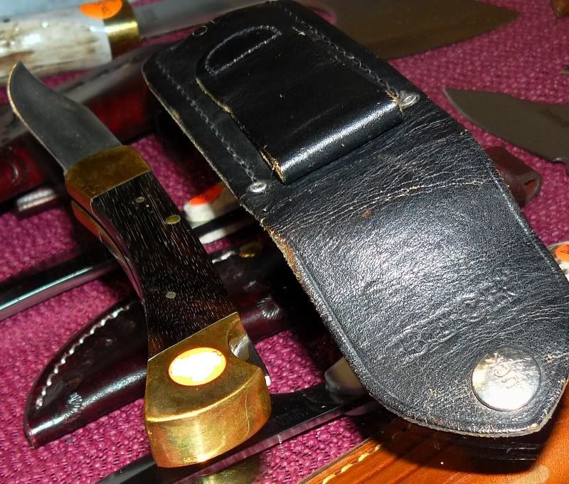

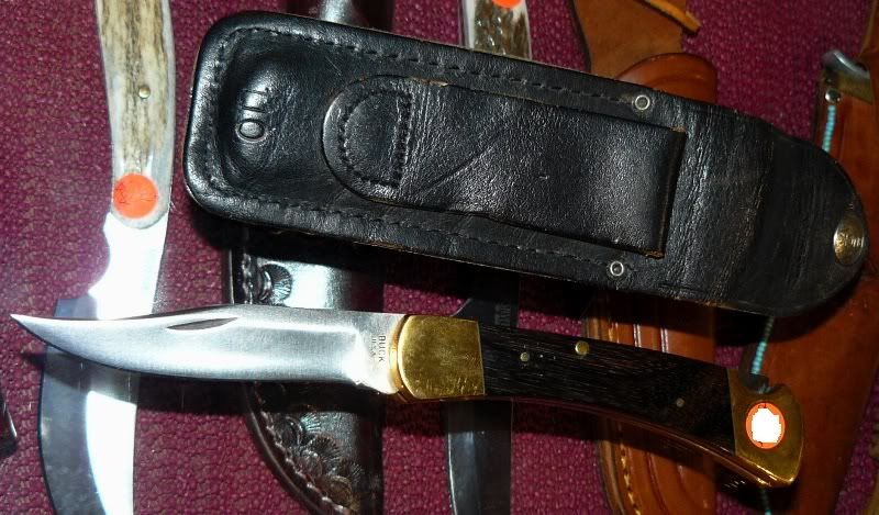

Vintage 110, inverted 2 line, wonderful condition with sheath, brass pins, brass lockbar pivot, brass spacer (QUESTION, is this a 3rd or 4th version and which variation or can it not be deduced from the three pics?):

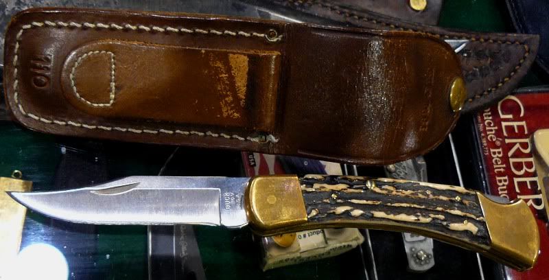

Stag 110 with sheath, 1989 tang symbol, sharpened and used, proud and sharp scale pin, barky stag and both sides matched:

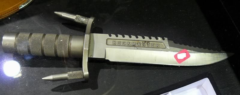

184 missing cap, sheath and accessories, probably unsharpened but dull, pins worn, all upper teeth sharp and intac (this knife needs a parts man ITE, oh yea, he had the gasket for the cap, said it was in his pocket)t:

That 110 looks to be a 4th version 1st variation since it has a brass spring holder not integral with the frame and the rocker rivot is brass.
OK. Thank you kindly imafritz. 4th version, 1st variation.
Here is Joe Houser's determinative portion of the roadmap, densely packed with information, for the 110 affi:
"Forth Version, Brass Spacer/Spring holder separate piece, 2 variations
Variation 1 (1970-1972)15
Stamp: BUCK, U.S.A., Inverted, Left hand, 440C steel.
Blade/Butt rivets: Visible on both sides of bolsters, 2 rear, 1 front.
Inlay rivets: 2 (tiny) or 2 small headed.
Rocker rivet: Brass, maybe headed.
Sheath: Black leather. C.
Packaging: 2 piece yellow box about 2” high-(1), Use and Care leaflet undated-(1) **""
I wish I had examples of both the 3rd and 4rh versions in order to plainly see the difference between the separate vs ingegral brass spacer/spring holder.
Joe and others have put some real work into diagraming the subtle variations in the evolution of these folders. These details, laid out as they are for everyone to read here in the forum stickies, become more impressive with more field work. Seeing the differences between the knives over time almost forces you to seek out, or even collect, in order have a visual reference vs a cerebral one. Awesome.

The show took place in a huge huge hall and this 124, 1st pic, was at the first table that I stopped at in a sea of tables.

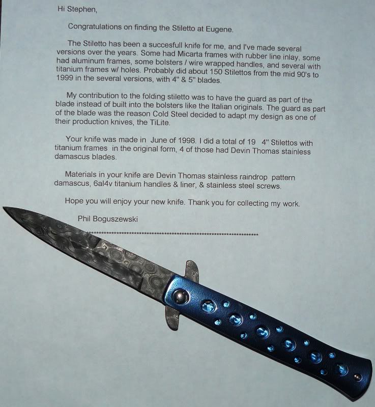

Story: One year at OKCA, unique to this day. A year when all of the collector cognizanti were at Solvang and not in Eugene, both shows took place over the same weekend. There was a table chock-a-block with pristine customs and highest-end production knives of fame and no two alike (no boxes). I acquired a vintage custom Boguszewski, in flawless condition, for a song and a dance (notice the jeweled liner). I should have bot them all. The vendor, selling only the knives, had bot the entire gun collection of a top-tier collector (now departed). The collection was kept under glass with a spectacular knife used as a spacer between each fantastic gun (so you saw, gun - knife - gun - knife - etc.) None of the guns or knifes had ever been used. The table was full of famous cutlery from multiple decades/generations. I spent as much time explaining the cutlery to a gun guy as the guy could stomach, which wasn't very long. I spent about 4 hours after speaking with the vendor until I returned to his table, he had sold nothing while I procrastinated, and bot the Bogi, one of four. I took all the time in the world and still got what my heart desired. Not last Sunday, however :) . You Mitch W., of course, are right.
