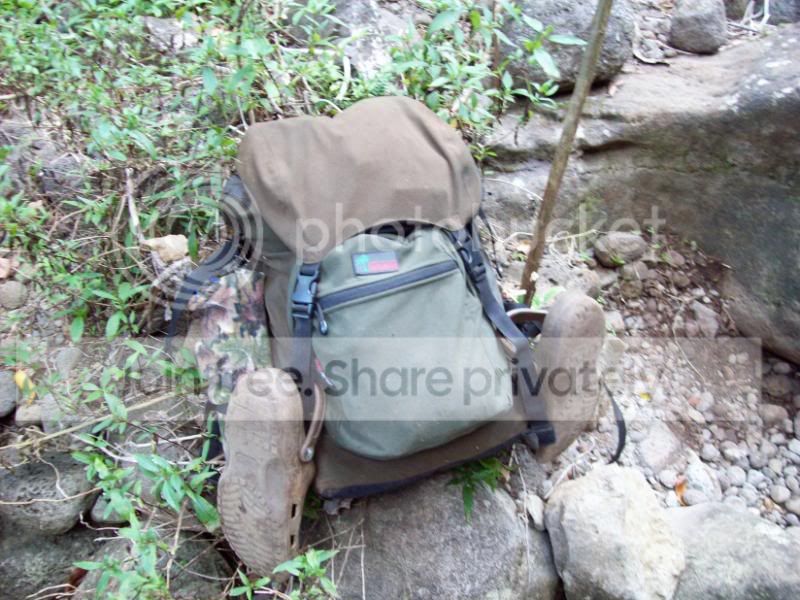

Well, I finally got my One Pack.
I got up the dough, and bought the Kifaru Zulu I'd been lusting over for some time now.
It's the exact configuration I wanted: foliage green, unpadded PALS belt, and standard top lid.
Shown there, it has the MSS black bag and bivy, change of clothes, first aid kit, survival kit, shelter kit (8x10 tarp, 2 bungee cords, 100' 550 cord), water filter and enough food for a couple days. Everything I need for a weekender and it all fits inside. Not shown are two ACU canteen pouches that go on the belt until I can scratch up the dough for Kifaru Liter Plus pouches for Nalgenes.
I plan to get two long pockets or back pouches to put on the sides for the extra gear needed for winter, or if I want to carry a week's food or whatnot, and maybe a pod for the sleeping bag if I need a LOT more room in the main compartment.
What I love is this pack can go from a daypack size deal, or be expanded for canoe or expedition camping with a few add ons.
For grins, I loaded a bunch of 2 quart canteens in it (full), scaled it at 59 pounds, and did 12 miles with it on Saturday. It was very comfortable, with the weight on the hip belt and most of the force on the shoulder straps on the front of the shoulders. Since it doesn't have load lifters, all of the weight can't be taken off of the tops of the shoulders, but the Zulu handles it as well as this style pack can.
It was all I hoped it would be. This is one of those things that you drop the coin on and hope you didn't make a mistake. I didn't, it's exactly what I wanted.

Cool pack! Help educate me. What is the difference between a Kirafu and a Maxpedition? I can see that the Kirafu has a lot of webbing attached which would aid in durability as well as versatility. But there seems to be a rather large price difference and I am just curious why the big difference in cost. Thanks!
Kifaru uses actual Cordura, Maxpedition uses ballistic nylon.
Kifaru is made in the US (paying US wages), Maxpedition is made in Taiwan.
Overall Maxpedition makes some really tough stuff, but I'd put them a couple tiers below Kifaru. Especially when you get into the larger Kifaru packs like that MMR and EMR, there's few packs of any make that can match the suspension system. Those that do, don't cost a whole lot less than Kifaru.
ETA: Keep in mind, also, that although the Vulture II has about the same CI capacity as the Zulu, it's divided into two pockets. While good for organization, it's not so good if you have something large you'd like to put in. Also, the Zulu has a snow collar that can be expanded into and adds about 1,000 CI of space in the main compartment. There's also 3 external pockets. The length and width of each side and one across the entire front panel.
And while the Vulture is Maxpedition's biggest pack, teh Zulu is int he middle of Kifaru's offerings, so brand-wise, Kifaru offers more versatility in its product line.

I chose it mostly on features: no zippers, especially holding the bottom on,. top loader (don't like panel loaders -- zippers again), can be used with or without a belt.
Then size-wise, I put together all the gear I take all the time, the couple different things I'd add to make it a true three season bag, and put it together, measured, and picked the bag that would hold it all inside. I actually had to call Kifaru and get dimensions on the bag, as volumetric measurements don't help unless I know the geometry.
The fact that you can extend the snow collar for an additional 1000 cubes, and add outer pouches to make it a 4-season bag, plus the three slot pockets are all cake.
Truth be told, I probably would have gone a bit larger with the ZXR if it didn't have the bottom zipper. But having got the Zulu, I can say the ZXR would have been too big to work well the way I want.

Yep, the 59 pounds was strictly to see how it handled the weight. The suspension isn't as robust as the MMR or EMR, and I wanted to see just how "bad" it got.
My usual 3-season load for a weekend is 28 pounds (weighed in the new Kifaru bag), including food and a gallon of water.
