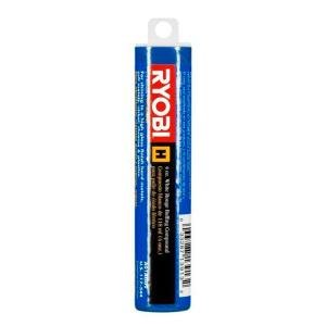

FYI, the Ryobi White Rouge I've been liking is the stuff they designate with the 'H'. On it's packaging (tube), it's marked as being 2-5µ particle size. I'm not sure this one's available anymore, as I'm not seeing it listed at Home Depot (where I found mine) or any other major retailers. Might be some being sold thru the 'Bay or other secondary market sites. Home Depot currently lists a Ryobi 'Hard Metal Cleaning Compound Set' that includes three smaller sticks of 'Emery' (black), 'Stainless Steel Compound' and the 'White Rouge'. Can't find particle size info on their site for these, so I don't know if the current 'White Rouge' is the same formulation as what I've got (seen below).
The 0.5-1µ particle sizes noted by Martin above seem finer than what I've been using, at least based on my results anyway (package marking aside).

David, If I can find my small block of white I'll break it down like I did to their black emery and apply a scale to it. Has been a while since I did that and maybe my recollection of particle size is a bit off, though I recall at the time it was a bit finer than the Sears white.

At times, I've incorrectly referenced my White as being 1-3µ, before going back and double-checking the marking on the tube. I've liked this compound, because it seems to come very close to a polish afforded by something smaller/finer, but still retains some wonderful crisp 'bite' I'd ordinarily expect from something slightly coarser.

I recall that their black emery is being listed at a pretty fine grade on the package, but when I broke down my block it was well into the 20u range with some in the 30 and a whole bunch of 'fines' in the single digits. I did a series once but didn't take micrographs of the Sears white and black, Flexcut Gold and a bunch of others. The results were not exciting, but I do remember the Ryobi white as being a bit finer and more consistent than I expected. I'll hunt around for my blocks, I know I didn't throw them out, but the branded material I have might not be the same as yours...
Business these days being what it is, they might very well be sourcing their compound from a variety of manufacturers, most folks using this stuff aren't going to be writing letters if it doesn't perform to honing levels of consistency from one batch to the next.
