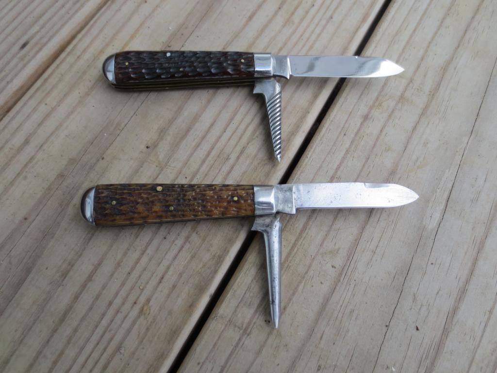

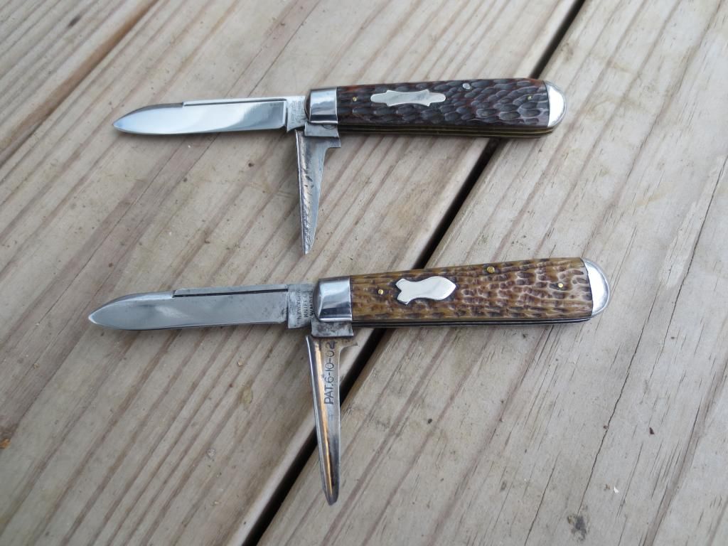

Very interesting. Any idea on the theory regarding the spirals on the backside?
Could you give some info on the spirals? Do you feel it helps open up the leather, or does it smooth out the hole????
Sorry for not seeing your question Josh. :o These two were gifted to me by Charlie (Waynorth) and here is his explanation on the two punches:
"The nice thing about patented punches is they give us clues about age. Here are two NYK HJs, one with a 1902 Harrison patent punch, and the other with a 1916 Fuller punch. The fuller is similar to the Harrison, with the addition of spiral grooves on the exterior, and a wider "roll" (hard to see) which serves as a guide and a finger lift for opening the punch."
I am not sure what purpose the spiral grooves serve, my guess would be like screwing into the leather, I will have to try them and find out.
First- thanks for the details Marksharp, I thinking Charlie might chime in here eventually.
Suprarentorial-Now 5hat is good stuff. Rather than slicing for stitching, that style and technique cuts larger circles. Never thought of it like that. Always thought of a punch as creating a slice for stitches. Learning something everyday.....
