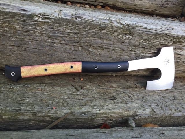

Hi Guys, now I know this is strictly speaking the 'knife forum' but I don't think a group of more knowledgeable steel fetishists exist.
I'm making an axe under the tutlige of an experienced blacksmith and was wondering (partially hypothetically) what the paragon of axe steels would be. Now I know this is a classically vague 'What's the ultimate steel?' question but I'm more interested in interesting or outlandish suggestions. Would 1kg of S30V make a nice axe?
The axe will be pretty close to the attached picture, I'm also open to suggestions for the profile of the blade as per the below 'objectives':
1. To maintain a fine edge after cutting Australian hardwood as long as possible.
2. For the Poll to be hardeneable and used as a possible hammer (not at the loss of edge holding ability).
The steels I'm thinking about so far are 52100, 5160 and S5. I'm no master metallurgist though and price isn't an objective in this hypothetical so throw any crazy ones this way.
I'm not worried about the steel's workability as there's a 250kg Massey power hammer involved. We'll differentially heat treat it too if applicable.
Thanks guys and girls. Let the quest begin.

80crv2 or S7 Or if money isn't an issue 3v.
I did this one out of 80crv2 and it has been unstoppable

Black g10 and shadetree tequila sunrise. I think the handle materials could be a little better though. As pertaining to your other post. The bit on this is 60rc and the haft and hammer are spring tempered back. I think it is a pretty good combo
