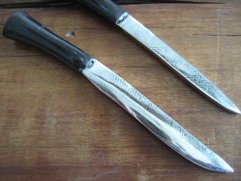

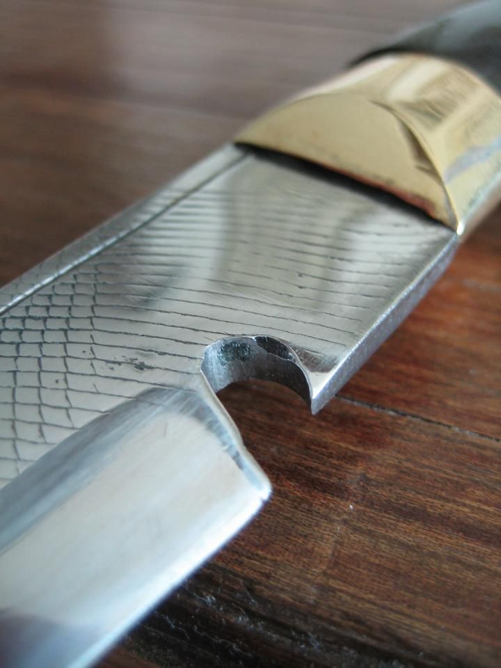

Upon scoring my grail khuk from Svashtar I thought the 18th Century would dot it.

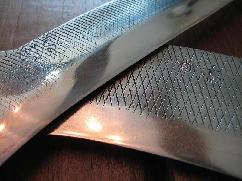

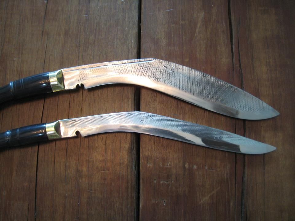

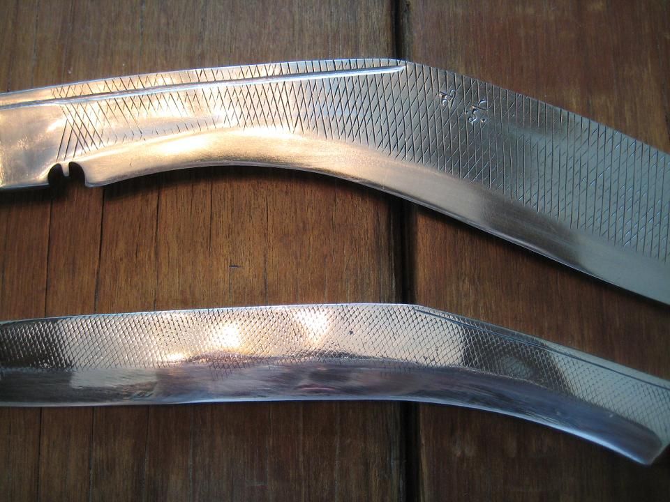

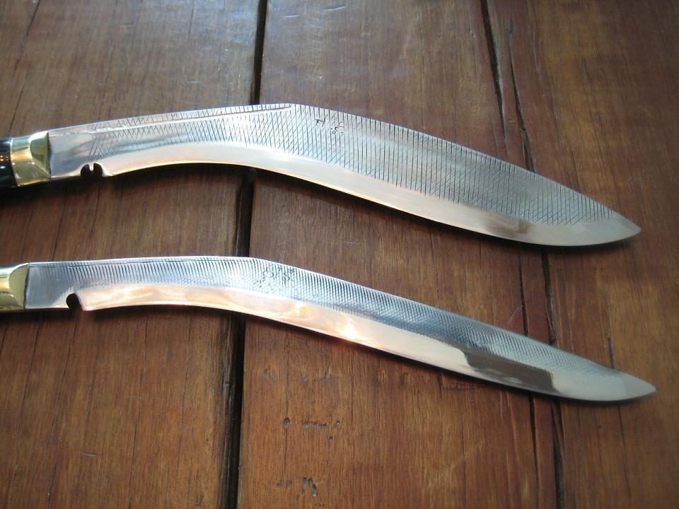

It wasn’t until 2 weeks ago Ted Palmer stopped that hiatus with a very obscure khuk I saw from Sta94- the Kumar Kobra that was made from a file with a reversed Malla cho and a single peening instead of 3.
Probably the liveliest khuk in my stash which I reckon at 15Oz or less for 18+” OAL.
Let the King out of the sheath!
My wild guess is that why Kumar decided to call this a Kobra eventually?

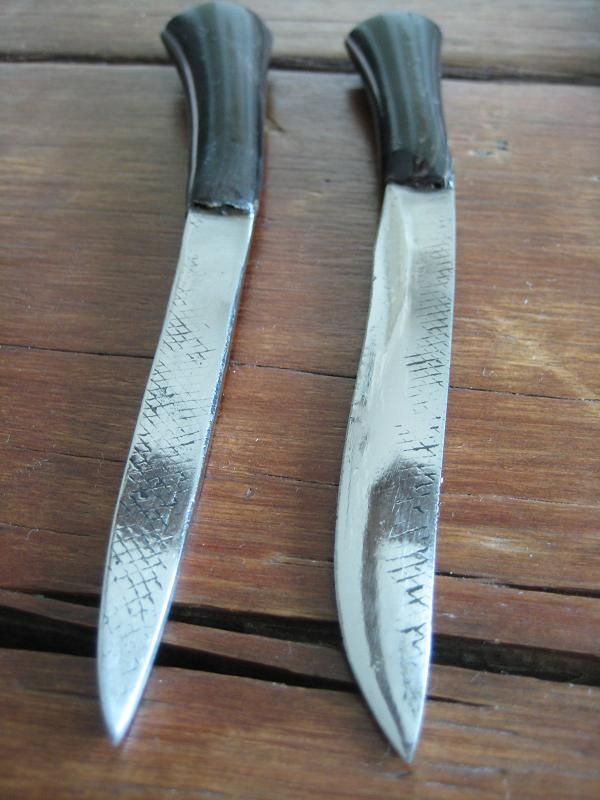

The detailing is superb that both Karda and Chakmak are made from the similar file as well!

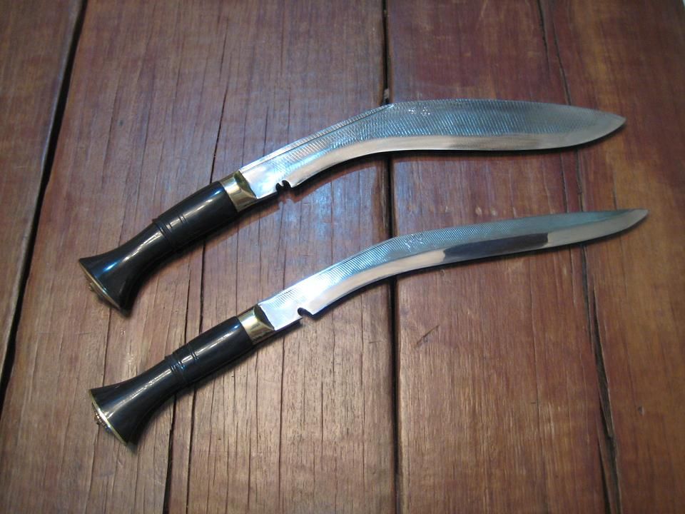

The Slithering Brothers:
I can't say i will stop but it's safe to say i'm content for now.:D
That is pretty cool. I knew you had the 18th century, but didnt know you had gotten sta94's file kobra.
All things end up where they truly belong, i suppose. :thumbup::)
I'm not a knife fighter by any means, but a light 18" Kobra is a mean blade to mess with. Fast, hits like a ton of bricks, and certainly lethal. Kumar aptly named the knife for sure:)
