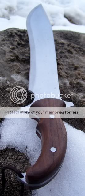

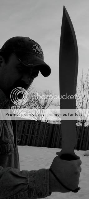

Hi guys. Finished this custom piece up for a customer this week. Hope you like it.
We will be adding this one to the web site soon.
The Resident Evil – Fully Functional -Influenced by Resident Evil 5
Measurements
Total Length = 24 “
Blade Length = 18 ½ “
Blade Width = 2 3/8 ”
Blade Thickness = 3/16 “
Handle Length = 5 ½ ”
Handle Width = 1 ¼ ” x 1 1/8 “

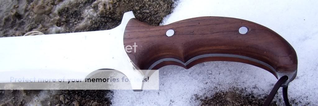

Handle: Walnut. Scales attached with exposed pins and glued.
Weight: 2 lbs 2 oz

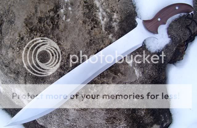

Sweet design, Archer. I really like the lines of that one.
One suggestion - increase the angle between the cutting edge and the tang just a bit. Maybe 15 degrees total or so? Really increases the torque on the strike when chopping (think Khukri).
Just my .00002 cents, so feel free to disregard,
Taylor
P.S. - What's steel did you use for the blade?

Thank you.
Sorry I forgot to put the shop details in there:

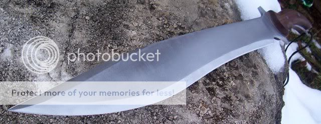

5160 Spring Steel was cut out and Normalized @ 1500 degrees until nonmagnetic, three times, to remove stresses and align crystals. Heat Hardened until blade became nonmagnetic, then quenched in oil. Tempered the blade to a straw hardness @ 550 degrees for 1 hour, letting it air cool and repeating once more.
Yeah, I guess I could have put more of an angle or a higher grind, but the fellow I made it for sent me a picture of what he wanted with measurements, and I followed it.

Thank you. Yes it is sharpened. It gets sharper the closer it gets to the point. I couldn't think of how to sharpen it and yet keep that taper on the false edge.

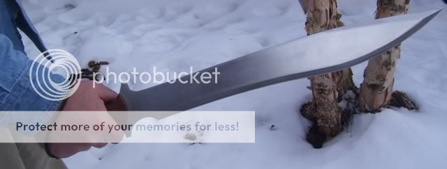

I wants dis... I causes even a literate fellow such as myself to utilize all manner of bastardizations of the english language. How is the weight balances with the handle, Archer? Is the handle curled enough at the bottom to facilitate an easy wrist roll? (Think Count Dooku) I studied FMA briefly and
I suspect that this would be excellent for bushwhacking.... Or swashbuckling, or ricochet cutting. Am I right?

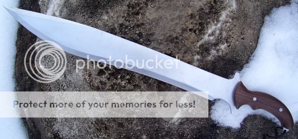

The weight balance is about 2 1/2 to 3" in front of the handle, and to be honest, it is one of my favorite choppers. Thanks,
