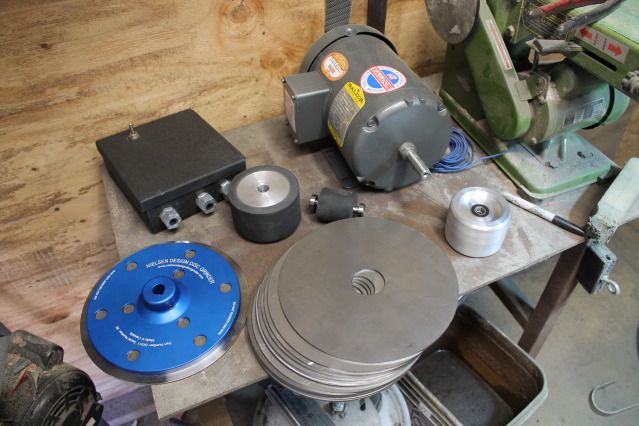

So I am finally able get a disc grinder put together, and I thought I would share a few pics as I go.
My dad has been scouring fleabay for motors, and we ended up getting a steal on the brand new Baldor for the disc.
I also just decided I really NEED a horizontal grinder and with a little creative engineering I should be able to build it on the cheap to.
All 3 of the grinders will be run through one kbac27-D VFD, by using 2, 2 way switches.
All I am waiting for now is the second motor to come in the mail.
I will post more pics as I go along.

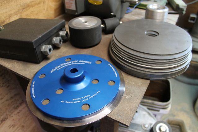

And WOW on the stack of plates for your Nielsen Disc System!!
Yeah Brian, I might have accidentally given the measurements to the laser operator at my work.....14 plates later.... :eek: :cool: :D
Nope, .125" cold rolled steel!!
That's going to be so cool - to just swap plates and keep going. With 14, you can even have 2 or three with the same grit and just change them all at once.

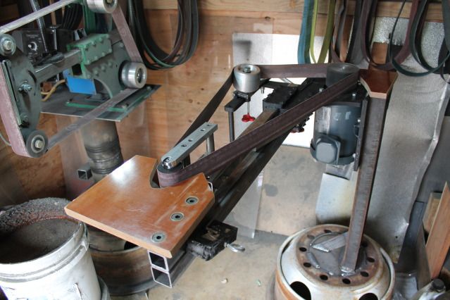

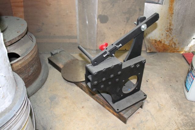

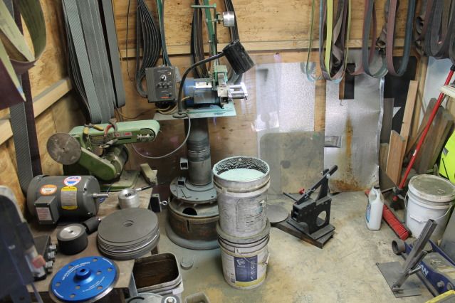

I made some progress on both grinders this weekend. I got the frames and stand basically done.
I just need to finish up the work rests on the horizontal, and then wire everything up.
Here are a couple more pics.
