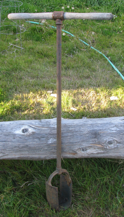

I brought this home today - and old Iwan Bros. post hole auger. I recall we had a couple sizes of these when I was a kid. I found them in our old barn, left behind by the previous owners. I remember that they worked surprisingly well.
A quick internet search found that Seymour still sells these. Anyone else use these before?
I've been curious about them but haven't been brave enough to give one a go on account of the large volume of rocks in the soil here. Nice find!
Similar idea to an ice auger. Probably a bear to turn in clay and useless when you try digging through roots or rocks. And in sandy soil I would expect the excavated material to leak out on the way up.
Sandy soil wont be a problem,( dry sand of course wont work) especially so if slightly damp.
Any soil if too wet is a problem. Just like any other digging in mud. Digs easy, it just weighs a ton & wont clear easy off the tool.
