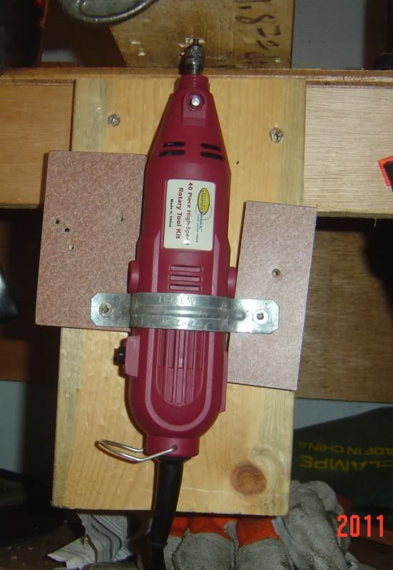

been thinking about this all day and this is what i came up with:
I think I am going to try the dremel router table. It is cheap and I have been thinking about all the other ways that I can use it for kydex. Maybe even less time on the grinder and the pocket Sheaths with pant hooks.
That`s what i came up with...i am not 100% satisfied i think i need to try a different bit the walls of the slots are not totally smooth
Sory for the bad angle & lighting
[video=youtube;JnyXjbU3cJs]http://www.youtube.com/watch?v=JnyXjbU3cJs[/video]

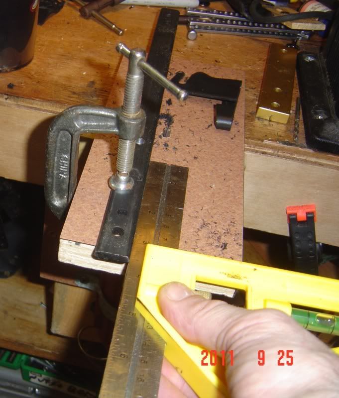

Oh hell ya that is awesome! Nice work Linos! I went with the Dremel machine and tried out a couple of the slots. The fence that comes with it does not impress me much, seems a little weak. What did you use for the table?
He must have pissed in someones`s cornflakes..his thinghy says banned...the table looks like those that come with various Harbor Freight sanders...
