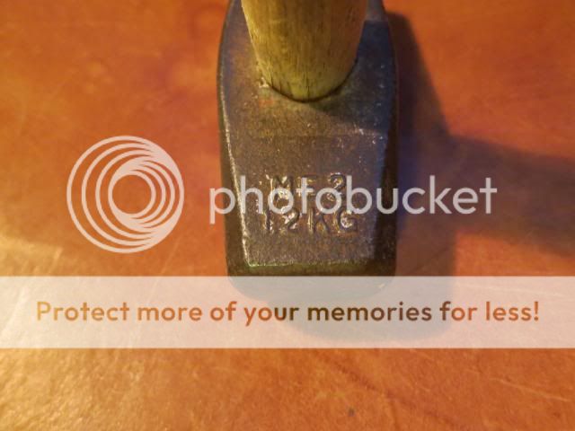

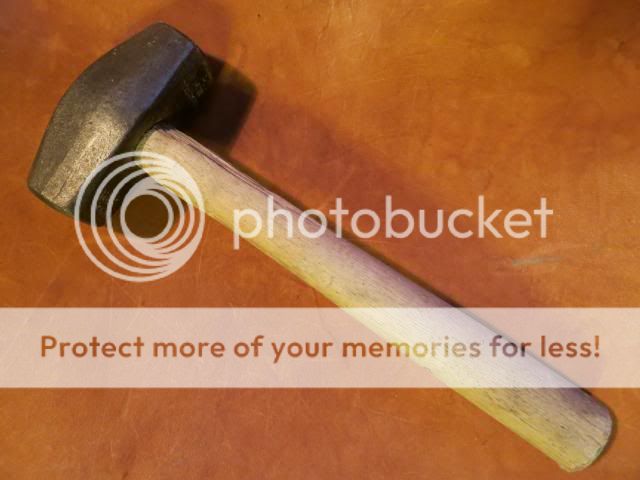

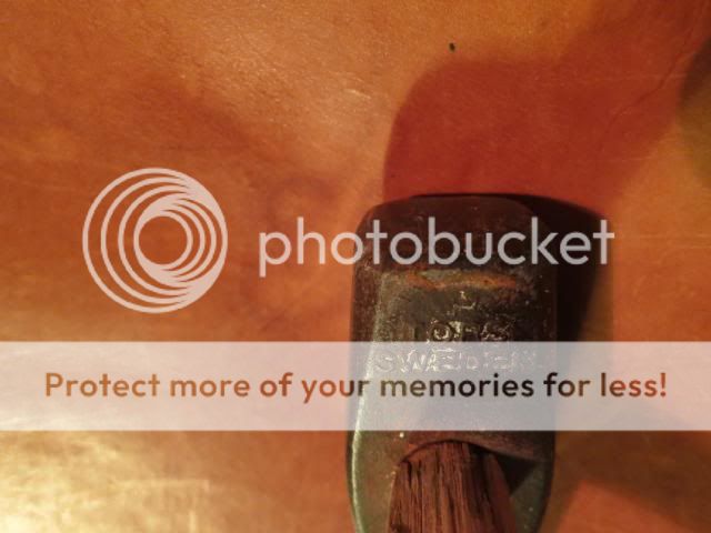

I just remembered that i found this hammer in the dirt by an old ship yard. Its a 1.2kg (2.64 Lbs) Swedish made hammer by the maker Tors (Thor's). Could It be of any use?

That's a drilling hammer. They're okay for forging. Honestly a ball pein hammer around a kilo or even less and a cross pein would do the trick nicely. I have a drilling hammer like that that I gave to my friend. He took a 60 grit belt to it with my 8" wheel and made the backside into a cross pein.
The second item you will want for a small setup is a 10-15cm leg vise. I have mine bolted to a 3" pipe with an 8"x16" tray that the mounting bracket bolts to.
I also use a blown propane forge. One great advantage of a blown forge in a small space is you can leave the blower on for thirty minutes after forging and it'll be cool/safe to put away.
