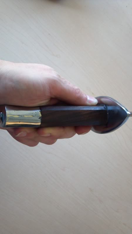

Check it out. It's a faux chiruwa:) Very comfy, very secure, very strong. Bhakkta did outstanding work. I'm really, really impressed!

So after we got home and got Evelyn to bed, I started to roll the heavy monster over in my hands. The edge took a frighteningly sharp edge. It will easily shave hair it's total length. One coolest and probably the most challenging thing to shape on the knife is the pommel at the end. Here's a picture:
I don't know if you can see it from the less than stellar phone pic, but the pommel is made out of white metal that pretty much exactly follows the contours of the angled edges of the wood under it. Then the butt plate is attached via some masterful brazing work. You almost can't see the line. It's also been peened at the bottom. Once you take into account the tight fit of the wooden grip, the 2 rivets and the exceptionally well done lanyard hole lined with a fantastically well done brass tube, you realize that this is not only one of the most bombproof handles but that a lot of care was put into the aesthetic details. This knife was not only built to do a massive amount of work, but it will flat out look good doing it;)
