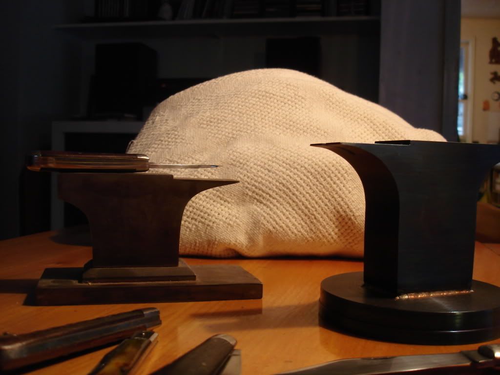

Handy to have around, the cutler's anvil is a neat tool. Also called a steady rest or "stiddy". In place of a horn, there is a thin projection that will fit inside a folding knife for various operations. The old brown one is from an unknown closed cutlery, coughed up by EBAY. The other, a friend made from T-1 steel, blued for appearance.

Nice Charlie! Two questions:
1.What's the notch used for?
2. Is that a sack full of Schrades behind the stiddies?
Eric
Eric, the notch lets you bridge a pin if you need to, or will allow the tip further in where the backspring pin "bump" is. Also if there is a stub of a pin to be tapped out, you can support the handle while you tap it. There are probably a dozen other ways it is handy.
The "bag" is full of money- gotta keep it somewhere:D:D (not). Actually it is just a white blanket to give some contrast so you can see the profiles!
The step down on the top is for krinking blades on the same spring so they will pass each other. It can also be used for krinking a spring to give it a little more load. They are very handy.

Here is a shot of somebody using a cutlers stiddy to "slacken" a blade.:D I have tried to find them for sale and they are few and far between. I'm going to have to make one.:rolleyes:

Tony or Kerry, what does slackening the blade mean? And how does, what that picture of Kerry's shows, do the slackening?:confused:
If you set the blade on there at an angle and tap the kick or the top of the blade it puts a twist on it and loosens a tight or lazy blade. It needs to be done before the pin is flushed off or it will make the pin show, but of course that can be fixed too. It's an old cutlers trick that an old Indian taught me.
