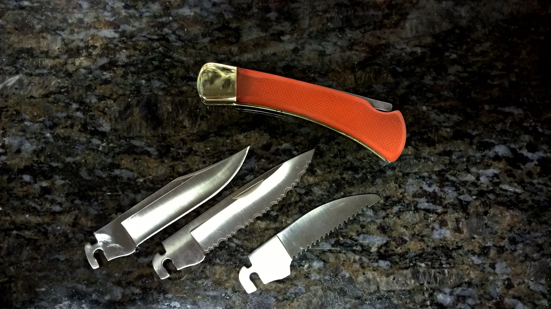

I am curious as to how Leroy adds Selector parts to a metal frame. The Selector pivot flat spot has to be immobilized at the 6 o’clock position so that the blade can be inserted and not pop out during normal use. This is accomplished by molding the pivot post into the Valox (plastic) frame. A blade can only be added to the handle when it is at a right angle and the rocker is depressed. I added the slot and the flat spot to the blade in this picture. Buck did not make BG-42 Selector blades.View attachment 1754153

Only 4 questions. Who is missing in action EEE? Who posted one of the best looking 110 Selectors? Who gave you the tip about supplying a body? Can the Take Apart 110/112’s utilize the new/current Selector blades?
The drawing for the brass frame selector can be found on the BCCI model history page in the customer designed stuff.
The bronze bushing has a flat side and is soldered to the pivot pin in that specific orientation prior to assembly.
No... new version selector blades done work.

OK, some of the mysteries are being solved. Buck never made loose slabbed bushings. When you cobble up your own, it must be oriented and immobilized. Leroy does it with solder. I do it by clamping the modified bushing between 2 handle slabs. The factory knives orient and freeze the bushing by molding it into the right hand handle (1st pic). 2nd pic is a slabbed bushing about to be clamped between the scales of a Model 186 Titan. Silly me, the flat spot is supposed to be at 6 o’clock not 12 o’clock.View attachment 1754910View attachment 1754911
