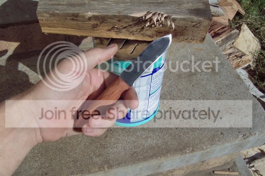

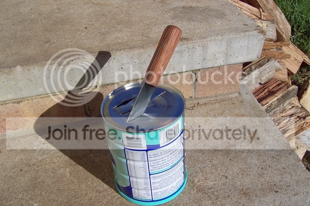

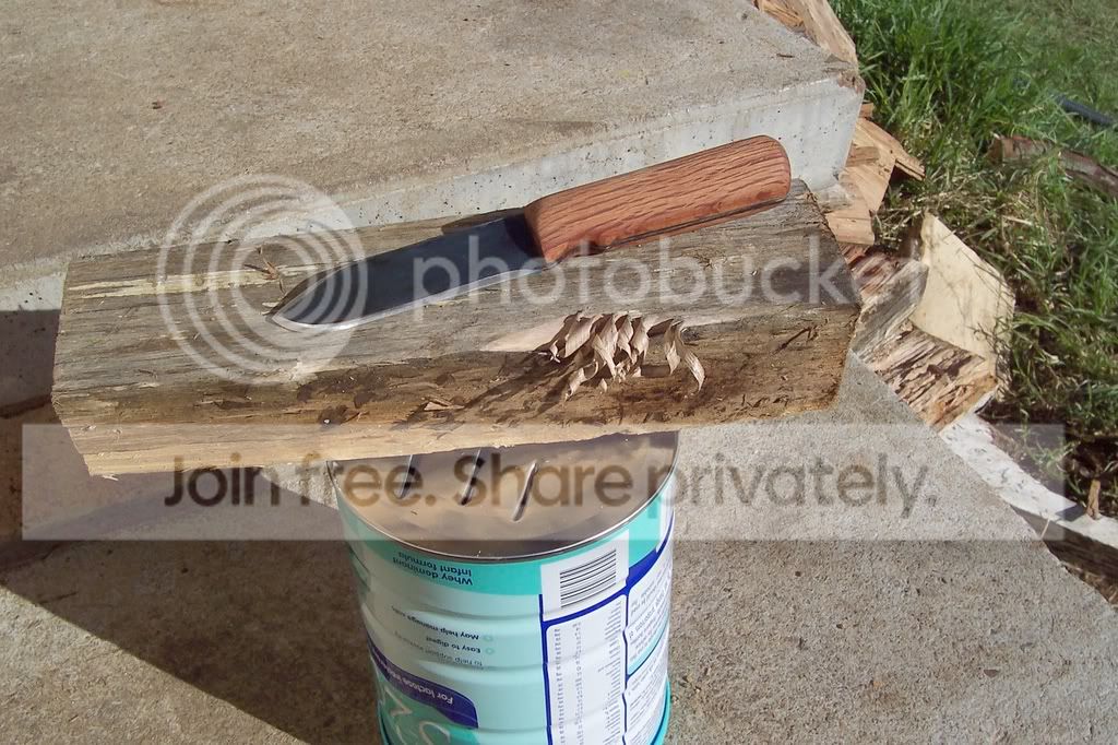

My fixed blades I make .. Ill mess around more with them ... flog on them with hammers as batons , cut sheet steel , pry with them , use them as screwdrivers at times ( wrecked a few screws tho ) I used to even loan them to people .. bloke next door borrowed one to cut up some meat ( he had no sharp knives ) .. he returned it most upset at the damage it did to his stainless steel sink he was cutting against ...
I use recycled all hard hss power hacksaw blades tho for blade stock ... or leaf springs for bigger knives . I see no point in settling for a good enough steel when there is steels that are seriously good that can be used just as easily .

They are not flash gear , very simple knives .
I made this one for my bro ... he wanted one that would cut seatbelts , I gave him one that cuts cars .. he has used it several times to save lives of people stuck in cars .
Made this for a girl who likes to hike .
this one was just an early effort at a light weight one knife does all type knife , this was more about edge retention than how to make a stove .
There is others I have posted up before as well .
