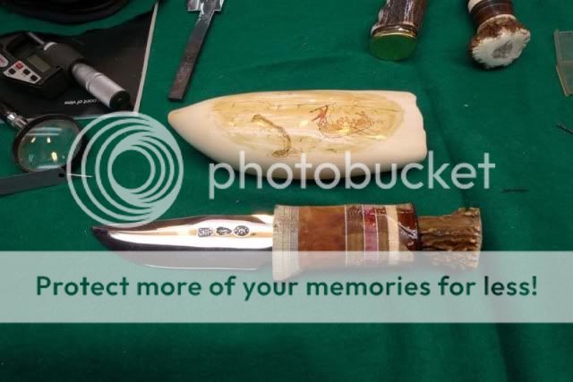

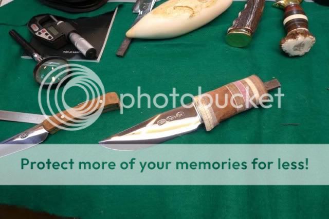

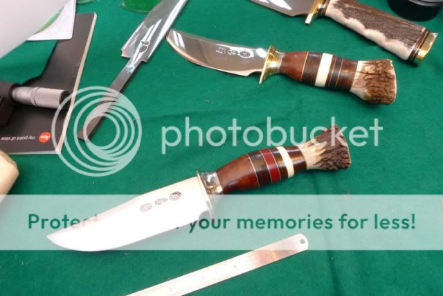

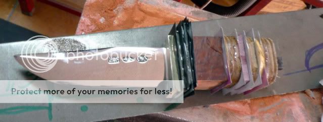

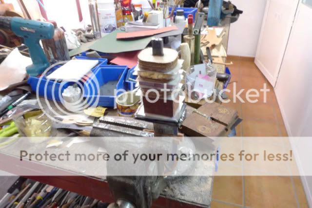

Well, I just recieved some snapshots from Rodrigo (www.2gknives.com) unfortunately the forging of the blade is not documented, but here the final steps!
Specs: 5" blade forged from 52100
Handle: German silver, aluminium and fiber spacers, wood, leather washers, bordeaux fiber, leather washers, ivory (pre ban), leather and stag crown.
Now I just need to wait until Pepín Vives will taylor a fine sheridan suit!
Any doubts about stick tangs? This is 6mm x 14mm, that's more than Randalls CDT.

Very nice! Looks great:thumbup:
I thought it was a super size sammich in the first pic:D
