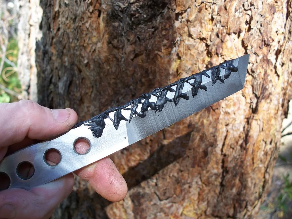

Clay on a tanto ready to go...

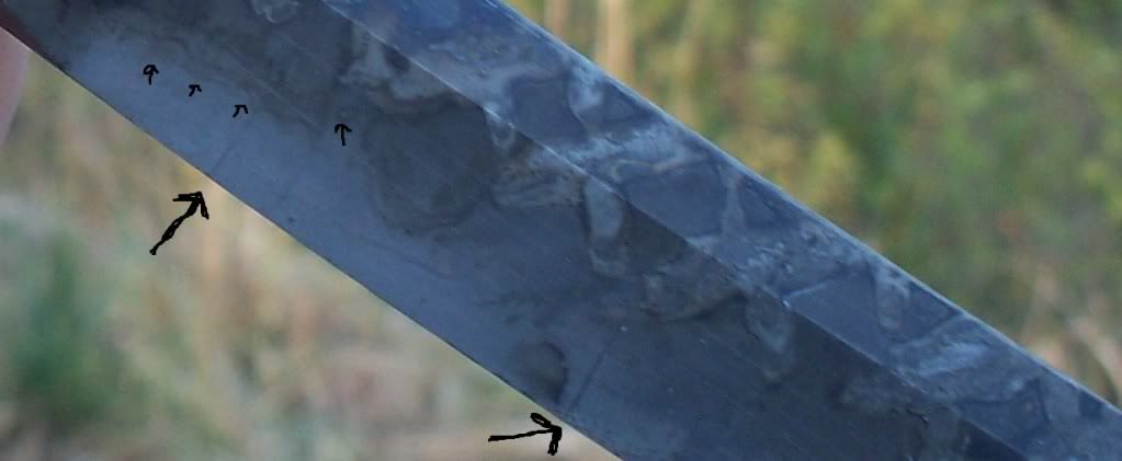

First off... check out the dramatic upward curve in the blade. This is known as "sori" in Japanese and is seen a lot in traditional Japanese blades. The blade curves upwards during quench giving them the shape we all know. With most steels the shape is ground or forged in but with water hardening steels a straight blade can gain a serious curvature.
Also check the big cracks, I heard two pings during quench and have two big ones... this one goes in the "forge later" pile.

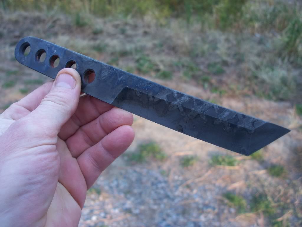

I should mention, that was the second heat treat, the first almost went well!
I did an interrupted quench the first time which usually works great with brine. I then spent a good while sanding and etching the blade and determined it was only hardened on the tip half of the blade. I could see the clouds of a nice hamon appearing but they faded away to nothing... a quick file test confirmed my suspicions so it went in for round two. (round two knockout, lol!)
The next one will be even better... :D

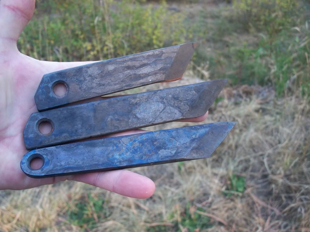

Here are some that did make it! They are more likely to make it through a brine quench because of the simpler shape and overall thicker shape.
I tried three different styles of clay on them and see potential in all. I can't wait to get them polished up and start the etch/polish process. I'm not sure on these dashis but I would have spent an entire day etching and polishing the tanto to make the hamon pop from just a wavy line to clouds. (if I was lucky!)
2 big arrows - point to cracks
small arrows - point to possible hamon potential
The clay was applied in a x pattern but that was in hopes for a very traditional looking hamon.
